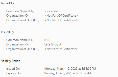

Not sure if this has been asked elsewhere, but today I tried to create a new control profile and made a new creation in the SBrick app. However, when I went to select a control profile, it shows "unable to fetch the profiles" for both public profiles and my profiles. This means I am unable to control my MOC using SBrick since it cannot get a control profile. Does anyone know how to fix this? I'm on SBrick v4.8.3 btw. Thanks!
I recently created a new profile and everything worked okay for me. Although I did copy one of my profiles for the new one. Now the sbrick profile designer says my PC clock is incorrect??? I can't trick it either.......I'll try again tomorrow. (I'll repost)
Okay, apparently the owners of the sbrick website(s) have not renewed there https certificate. So until those guys fix this our sbricks(not programmed) are just "paper weights"........so sad.  :pir-bawling:
22 hours ago, pasztorl said:
can you please try again? we fixed the certificate issue
Still the old certificate..
%7BfileStore.core_Attachment%7Dmonthly_2025_09/image.png.9cb2d26b23c751659a645719e54398a2.png
