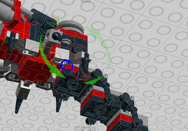

This isn't a piece bug, but a functionality bug: try to rotate the pieces attached with the robot arms on the tail of the shrimp... vehicle... excavator, and look if you can keep the main body stay horizontal, I had to rotate the pieces by detaching them and then put them in the right position.
LXF file
Since a similar connection appear on one official set, I would like to see if the entire palace explodes if you rotate one of the lasers above the door (my creation did it once :D)
It works quite fine for me.
The rear pieces will move and the body will stay still. Please remember that you need to click on the black pieces many times. Each time you click you will change the rotation point.
If you have selected the right rotation point, the rear pieces will move nicely until they collide with another brick (marked in blue in the image), and then LDD will try to rotate around the "obstacle". Personally I think a better behavior would have been if LDD didn't try to be "smart" here and just stopped rotating when pieces collide.
PS: Nice little model. I like the insect like look of the...thing :classic:
On both my computers (home and work), when I try to rotate one piece, doesn't matter if I try to rotate the body part or the tail part, everything rotates, not just the piece I selected.
For example if I select the robot arm, it rotates the wheel mount piece quickly around the connection point (doesn't happen all the times and every time with a different speed), if I select the wheel mount piece I end up with a sandwich most of the times because both the robot arm and the other wheel mount piece connected on the other side rotates as well.
I'll make a video as soon I have time.
@Wolfolo
Note that sometimes a single part has two or more rotation points/chances.
Clicking more time on the part, you switch among the different rotation points.
This thing don't work ever properly, but with a bit of insistence and trying from different angles...
I usually adopt the technique "divide et impera". LDD have difficulties with multiple rotatable connections.
Yes I know how the rotate, hinge align and flex tool functions work, I built half of the the UCS R2-D2 and the UCS Millennium Falcon using those features before my pc crashed :P
Maybe I'm not so good at telling the right problem, so I made a video which you can grab here: https://dl.dropboxus...20-08-53-14.mpg (750KB)
This video shows how a piece attached rotates freely when it should stay in position, on my MOC it rotated not just one, but 3 of these pieces at the same time!
At the end I also blocked the rotation and the only way to unlock it is to disassemble the construction :D
EDIT: fixed the link because I tidied up the dropbox folder
Edited by Wolfolo
Or maybe I'm not so good at understanding! :grin:
Anyway your problem happens when there part has more rotation points, and I haven't find any solution than disassemble the part, rotate, reassemble. The "divide et impera" I quoted before.
Clearly the rotation tool of LDD need some improvement! :wink:
