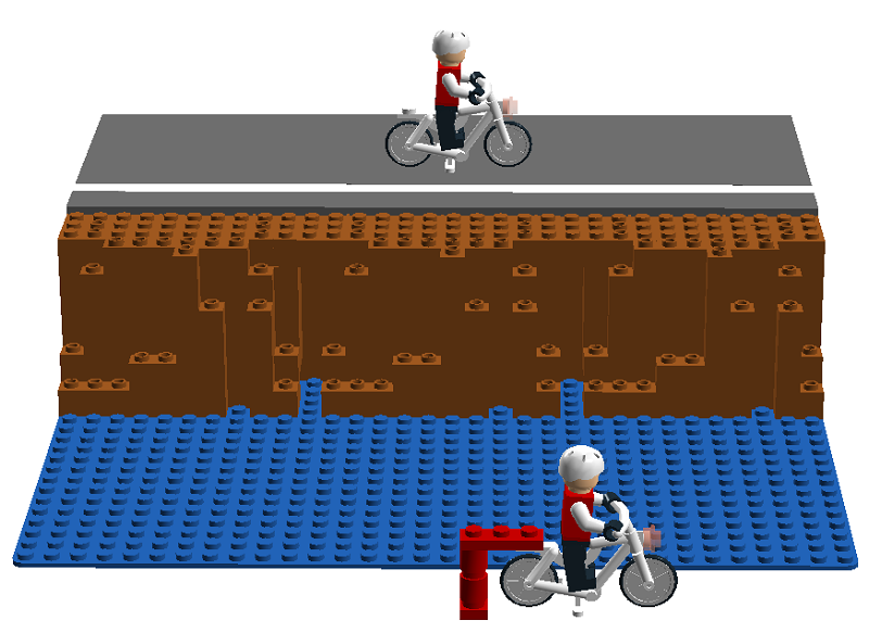

Snowspeeder Pilot Posted March 9, 2013 Posted March 9, 2013 (edited) Hello Chaps, I hope you can help me on this, I am trying to place a bicycle on a tile but it's not possible. Do you know how? Do I need a special brick or something? Thanks in advance. Image Edited March 9, 2013 by Calabar : Oversized Image converted in Text Link. Maximum size allowed is 800x600 pixel. Quote
Calabar Posted March 9, 2013 Posted March 9, 2013 Try using a scaffolding. The trick consists in selecting the bycycle toghether with another piece that you can move freely. Select both, move the other piece and the bycycle will be moved with it. I converted your oversized image in a text link and changed the title of the topic with a more significative one. Quote

Calabar Posted March 10, 2013 Posted March 10, 2013 @Luke_likes_Lego You are true, I supposed Snowspeeder Pilot was asking help for LDD because the image seemed an LDD screenshot and because it is a typical difficulty for LDD builders. Let's wait the he will clarify the situation (and if necessary I'll edit the thread's title again). Another solution in LDD could be to place a 2x2 plate under the bicycle, because the bicycle has a "hook" thought to fit among studs. Once placed the bicycle replace the plate with the tile. It should work if LDD has correctly implemented this connection. Quote
Sjuip Posted March 10, 2013 Posted March 10, 2013 Another solution in LDD could be to place a 2x2 plate under the bicycle, because the bicycle has a "hook" thought to fit among studs. Once placed the bicycle replace the plate with the tile. It should work if LDD has correctly implemented this connection. Alas, @Calabar! I checked and it does not work in LDD: bicycle 73537 will not fit onto a plate with studs (such as 3022) like it does in real life . Could this be a bug? Quote
Calabar Posted March 10, 2013 Posted March 10, 2013 Oh, ok, forget it then! Yes, it seems a bug, or a misconnection at least. Quote

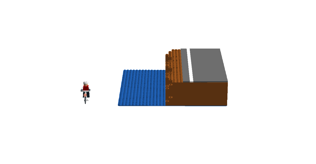

Snowspeeder Pilot Posted March 11, 2013 Author Posted March 11, 2013 Hello Guys, thank you so much for your help! Yes, I am trying to find the solution on this on LDD. Using your tips, I did this. Then, I move all to the place that I need, I deleted the parts and this is it. Quote
