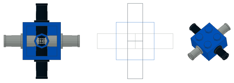

laix Posted February 2, 2012 Posted February 2, 2012 (edited) Does anybody know of any Lego bricks that are 2x2 studs in width and lengh, and also have a 'peg hole' on each side?. It should be impossible to have 4 peg holes in a 2x2 brick. I made a short test in MLCAD and that's the result: The pegs would intersect each other. Edited February 2, 2012 by laix Quote
Front Posted February 2, 2012 Posted February 2, 2012 It should be impossible to have 4 peg holes in a 2x2 brick. I made a short test in MLCAD and that's the result: You could make a part like it, but yes it would only allow two pins added at a time. And the geometry where the holes interfer will be quite odd. Don't expect a part like this ever to appear, because you can't use all holes at once, which makes it kind of useless. In fact you can't use any two holes at the same time, that are at 90 degrees to each other. Erland Part Design Quote
Blakbird Posted February 2, 2012 Posted February 2, 2012 It should be impossible to have 4 peg holes in a 2x2 brick. I made a short test in MLCAD and that's the result: The pegs would intersect each other. Even with only 2 pins holes, the pins would intersect the center tube which would be a problem. The easiest way to do this is just use two 1x2 Technic bricks back to back. Like you say, there's no way to allow pins on all 4 sides at the same time. You need 3x3 (or more) for that. Quote

MMR1988 Posted February 3, 2012 Posted February 3, 2012 It should be impossible to have 4 peg holes in a 2x2 brick. I made a short test in MLCAD and that's the result: The pegs would intersect each other. What if it would be anything where you can use the short side of a 3/4 Pin? I think, this should work... But, nevertheless, I don't know for what it could be needed... Max Quote
