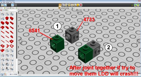

Hello everybody, i'm Ale and I'm a newer over here, i wanna share with you one bug very boring in LDD. The brick 1x1 with knobs (4733, 47905, 87087) once joint with a techinc brick 1x1 (6541) if try to move them together, LDD crash (you can seee the picture attached)!!! :hmpf_bad:
After you open it again, it's going to remove them from your design coz it considers wrong assebly!!! This bug comes from the ver.3 till the newest release 4.2.
This is very pity bug coz this way to build parts is very common in many project... Anybody has some suggestion? Or found it before?

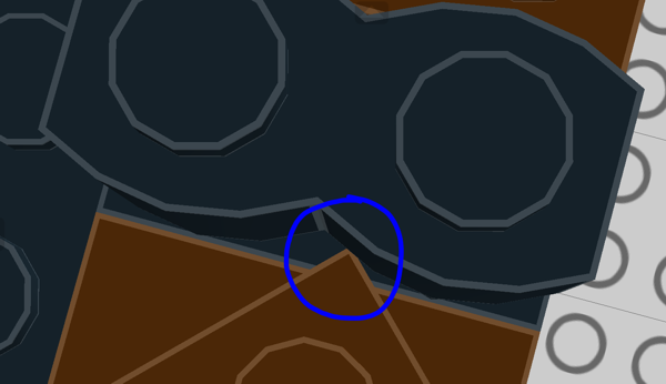

I dont dare to say, that Jamie made a no-no in the corner section of the CC 1. floor. I know it IS possible, cause i'm sitting with the original right beside me on the desk. But i can't make LDD do the same trick, and make the curvy 1x2 intersect with the 1x6 plate in the 45 dgr. angle. It should be alligned with the edge of the wall. but it cant....
Hmm, that is close. If you place a 1x1 round plate and then a 30136 1x2 brick on top of it, you can see it clips into the 1x6 plate. It might have been judged at design review that there was some leaway in the 2x2 turntable joint, and it was therefore legal. But you can try this yourself. Try to stick a piece of paper in the gap. If it will slip in and out freely, it's OK. If not - you found an illegal build.
