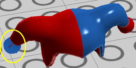

Stephan Posted January 19, 2012 Posted January 19, 2012 Hej, this is the first time that I repport a bug in LDD, so I hope that it helps you: I've found a color bug with the Jester Hat (part 62537). It's possible to get it from the palette in the 'Regular LDD', but it seems the right pom isn't colored right. In LDD Extended it's also not possible to color the two poms differently. Quote
Superkalle Posted January 19, 2012 Posted January 19, 2012 On 1/19/2012 at 11:49 AM, Stephan said: Hej, this is the first time that I repport a bug in LDD, so I hope that it helps you: I've found a color bug with the Jester Hat (part 62537). It's possible to get it from the palette in the 'Regular LDD', but it seems the right pom isn't colored right. In LDD Extended it's also not possible to color the two poms differently. Hi there. Welcome to the forum. Good find on that bug Quote

Stephan Posted January 19, 2012 Posted January 19, 2012 Quote Hi there. Welcome to the forum. Good find on that bug Thanks :) I've an update on that Jester Hat: If you color the inside, the poms are colored the same. Quote
