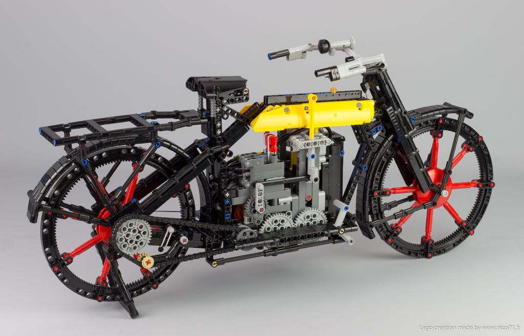

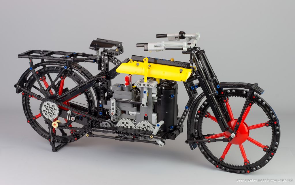

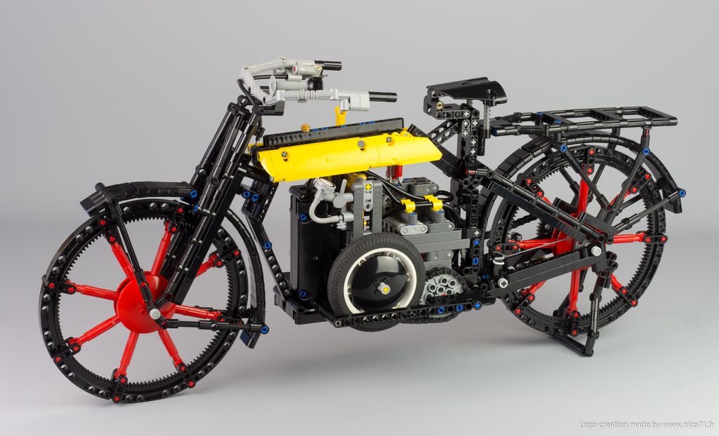

Steam Bicycle
A new creation A steam bicycle, powered by a Switchless Lego Pneumatic Engine. Features steering, transmission with a two speeds gearbox, rear brake and working throttle, with building instructions.
lego-steam-bicycle-1
Context

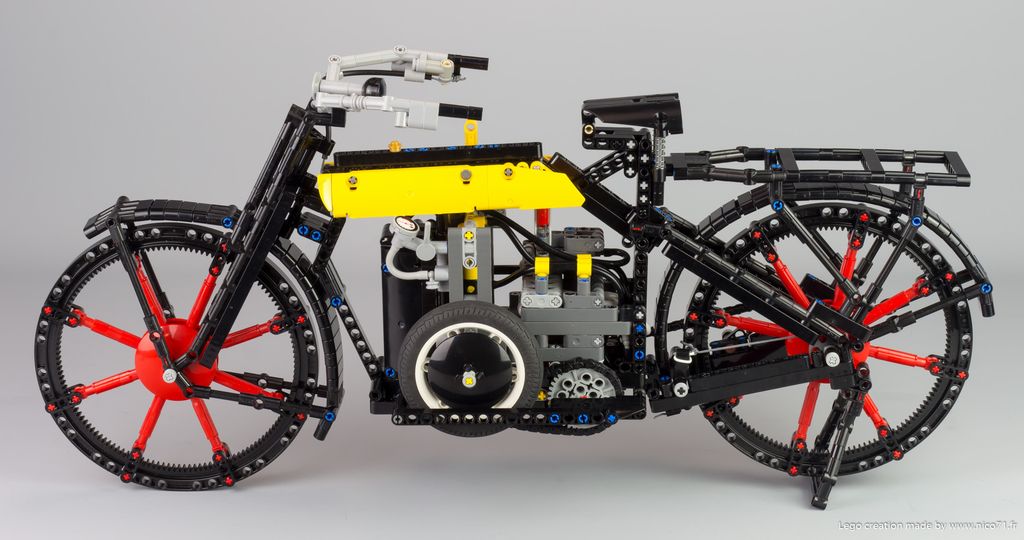

As written before in the article of my Switchless Lego Pneumatic Engine, I wanted to create a pneumatic engine which can run without switch to avoid the hard deadpoint and enables people to build a functional engine without modifying parts. I have created a functional prototype and then I wanted to improve it to install in a creation, here is the result.
lego-steam-bicycle-3
Functions

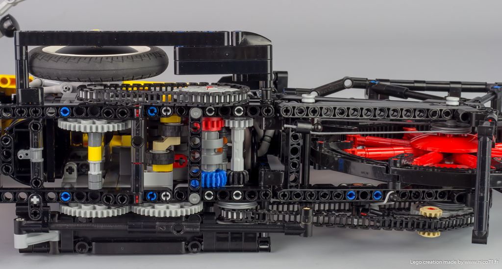

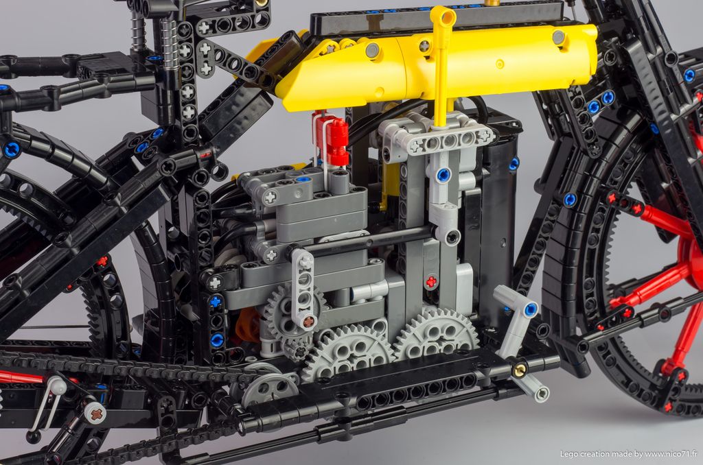

The main difference between classic engines and this one is that I used pinched hose instead of switch. Rather than pinching the hose in the diameter (which require lot of force), I create a loop with the hose, which is tightened more or less with a pusher. The pusher is then connected the the crankshaft to create the distribution on the two chambers of the cylinder. The main advantage is it requires less force to operate the switching of the chambers but need continue air flow. You can watch in detail the principle of functioning of this engine here.
lego-steam-bicycle-5
This single cylinder engine is based on the same principle, but rather than having sliding head-to-head pusher, I use independent pushers which are controlled by roller cam. This solution have the advantage to be more compact, have a better air timing distribution and less friction thanks to the roller. The gearing between the crankshaft and the cam is made with two 40-tooth gears, which enables a fine tuning. Then, the motion of the crankshaft is transmitted to the gearbox with a chain and is operated by the level on the right side thanks to a rotating gear shifter. An additional flywheel on the left side helps to increase inertia to make it run smoothly.
lego-steam-bicycle-16
The bicycle is equipped with a working throttle. To make this function, I have used the same principle as for the valve (tighten loop for pinching hose). Two rubber bands keep the pusher in down position which block the air and a rope is attached to it and to the throttle by passing to a 3mm flexible tube .When the  throttle is rotated, the rope is pulled and the pusher raised, which open the air flow which make run faster the engine. The idle can be control by setting the rest position of the pusher.
lego-steam-bicycle-12
The last function is the foot brake at the right side. This is more a “speed reducer” than a break. It uses a rope attached to the chassis though a rubber band and pass around a pulley on the rear wheel. Then the other extremity is pulled by a lever connected to the pedal. The rubber band enables a return to the rest position with a small tension (if not it goes off the pulley) without too much friction. I would like at the beginning to make a front brake too but it was too complicated as the outer diameter of the wheel is not contact due to the way the spokes are attached.

The heart of this creation was the engine, but of course I tried to make a decent looking. It comes with colour choice to highlight the engine with black frame, yellow reservoir and red wheels and a “steampunk” looking with the yellow colour and hose. I have also added some details like the package holder, mudguard, horn, gauge, spring loaded saddle, stand etc. At the final, I am very happy with the design and details despite the lack on rubber tires and I think the functions are part of the design this time, with a nice looking sculpture which can run (but of course not drive).
lego-steam-bicycle-6
Performance, Pictures and Video
The performance are quite good considering the purpose of the engine : to be built with non modified parts at a standard running air pressure (3 bars). It runs fine and can achieve good speed (nothing compare to a modified LPE with thousand RPM) and accept to run low too. But, it has also drawbacks linked to the heart of how it works.
The first is the hoses used for the 4 loops which make the distribution (4x 9cm lenght) : they have to be soft enough to have an easy pinching and strong enough to handle the pressure. For instance, the last hoses in the 42100 are glossy and hard to pinch, the very old pneumatic hoses from 90’s is too soft for me and do not handle the pressure. The ideal hoses are those which come from the sets from some year like the 8436, or the 8455 (mine comes from this set), you can use also the hose from the 811042043 if they are not the glossy version. You can use other hoses but you will need to increase the pressure if the hose is too hard to pinch and reduce if it is too soft (with of course limits). As I have not tested, I can not certify it will work with every hose.
The second drawback is that the air flow and air pressure affect the required pinching force and then affect the functioning.  The air flow have to be constant to avoid the problem of running, that is why I do not recommend to use it with Lego pump and/or airtank but rather an other source of air like a compressor / pump with a air reservoir which enables to have a constant air flow. The air pressure is less sensitive but I notice it runs the best with the hose I have between 2.5 to 3.5 bars. Less than this value, the engine has not enough power to run and stop, and with more pressure, the hose do not handle the pressure.
I have not seen any wear on the hose, even if they tend to keep the shape of the loop some time after dismantling, they recover their original shape without any leak or damage after some time. But I think it can be damage if they rest for a long time on display with no pressure. So if you display this creation, remove the upper pneumatic T connector assembly to loosen the loop.
 You can see more HD picture on my website and get the building instructions. You can see the list of part here on rebrickable : https://rebrickable.com/mocs/MOC-48400/Nico71/steam-bicycle-lpe/
