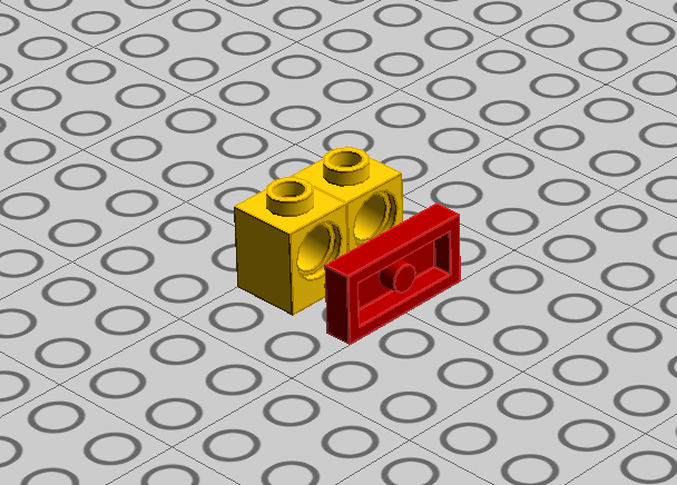

Plate 1x2,1x3,1x4,etc should fit together with Technic Brick 1x1,1x2,1x4 (6541,32000,3701)
Nope, any plate bigger than 1x1 is not legal because of strain it may put on the child.
Well, it depends Zblj. The rules (as far as I know) are :
1) Only a single stud per element can be placed in a Technic hole, i.e. cannot put both studs of a a 1x2 plate in the two holes of a 1x2 technic brick etc.
2) Studs in Technic holes should only be used for decorations, not for structural design.
So you should be able to do what Kroom says. There was even a SW mini a few years ago where a the center stud of 1x3 plate was put in a Technic hole.
What about this combinations?
That's a perfect example of when it ISN'T a legal connection—connecting a piece to a Technic hole by more than one stud locks the parts together too tightly.
I wouldn't mind if connectivity like this were added, if only because I frequently use the offset between bricks with side studs and bricks with Technic holes to make minor adjustments to the position of floating bricks (or supposedly-attached bricks on sets which feature technically illegal connections) and it can occasionally become frustrating to have to recall which bricks have connectivity and which don't.
