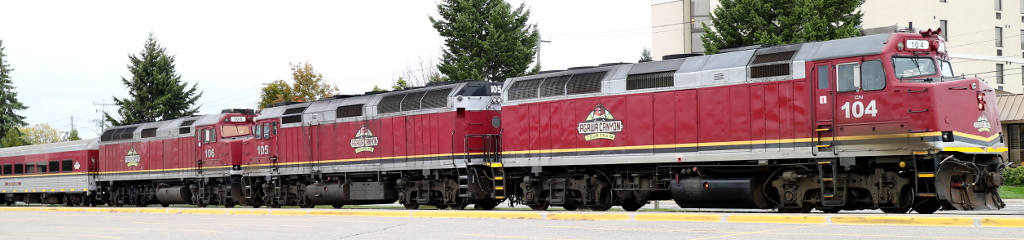

Due to the train baseplates, bogie plates etc. available, I've chosen to build one locomotive and two passenger cars.  Typically the real train runs with 3 locomotives and around 15-20 passenger cars.  It runs a point to point route in Northern Ontario, including the namesake Agawa Canyon, and the remote destination is not much more than a washroom and some historical items from the railroad, so it runs locomotives at both ends and returns without turning around.800x600.JPG
Most of the train is formerly Colorado Ski Train equipment, including the EMD F40PH locomotives and the passenger cars that match its paint scheme.

Here's a photo of the real train to give you an idea.
8091336702_bd8bd54d0d_c.jpgDescent to Montreal River by Billy Wilson, on Flickr
