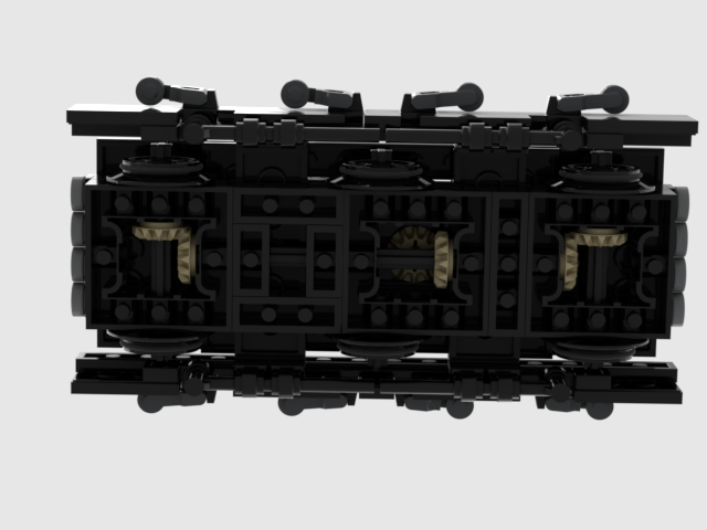

slagbijnieuwpoort1600 Posted June 20, 2024 Author Posted June 20, 2024 Thanks for all the help! It took me some time to process all the advise and work a bit further (and I'm still quite slow in digitally building). I decided that a blind driver in the middle would be a good balance between ambition and realism for me. I saw quite some 4 x 4 technic bricks with hollow centers in the different bogies from e.g. @dtomson, and I guess this will increase the strength of the bogie by using these instead of 2 1 x 14 technic bricks? I therefore extended the bogies a bit so that it now looks like this from beneath: I didn't replace the wheels on the middle axis yet, because I'm still undecided on using the Hockey Puck, a round tile + plate or even move to M-wheels that UrbanErwin used as well. At the DSB Litra MZ III bogies I see that a 4 x 4 turntable is used instead of making everything flat. This is probably to increase the strength of the connection between the bogie and the body, right? I think I'll apply that too. On 5/8/2024 at 1:25 AM, Hod Carrier said: How you power the loco will depend on what sort of performance you want. The fastest motor is the train motor followed by the Technic M, L and then XL as the slowest. You can always gear the Technic motors up for a bit more speed, but that will require some space inside the loco or bogies to accommodate it. If you're feeling very brave you can still use the train motor with Technic bogies to get the look and speed you want, but it's not an easy technique. Expand Regarding the motors, according to https://www.philohome.com/motors/motorcomp.htm the XL motor is a bit more efficient than the train motor, but I'm guessing that this is mostly because no gears are involved, so you loose this (and maybe even a bit more) when adding the necessary gears to an XL motor? I would however also like it to be able to move a bit slower then with the train motor, and with a higher torque the speed stays probably also more constant in curves and when climbing a slight slope? With the battery I used (a 9,4V Zenter battery) in my V100 with train motors the locomotive is even a bit too fast for my taste. With M-wheels the speed would be even higher. A train motor on the side would still probably fit in the model (the locomotive is quite large and the sides are relatively simple 1-wide bricks), but aren't you then loosing on performance because only one of the two axle holes is used? On 5/7/2024 at 9:09 PM, zephyr1934 said: It all depends on how long your equipment is and what size curves. If you are using normal lego curves (R40) you'll probably need couplers on the bogies, if you are using wide radius curves you might be able to do couplers on the cars. Best way to find out is to MOC up a few flat cars of the desired lengths and see if they work through all of the switches and curves you want the train to work through. The flatcars will let you quickly prototype ideas without the risk of having to massively rebuild a MOC. Then once you get it, you can keep the geometry as you move to the actual cars and locos. Expand I already have the carriages so I will start experimenting with a flatcar as locomotive whether it is possible to connect the couplers to the body. It will probably then also help to put the technic bar that connects the body + motor and the bogies as much to the front (or rear in case of the second bogie) as possible, am I right? I was already trying to do that in the current design shown above, but I could move the bar one stud further to the right but then I cannot keep the 4x4 technic brick with hollow centre at that location. Thanks again for all the help! Quote

zephyr1934 Posted June 23, 2024 Posted June 23, 2024 On 6/20/2024 at 9:05 PM, slagbijnieuwpoort1600 said: I already have the carriages so I will start experimenting with a flatcar as locomotive whether it is possible to connect the couplers to the body. It will probably then also help to put the technic bar that connects the body + motor and the bogies as much to the front (or rear in case of the second bogie) as possible, am I right? I was already trying to do that in the current design shown above, but I could move the bar one stud further to the right but then I cannot keep the 4x4 technic brick with hollow centre at that location. Thanks again for all the help! Expand Yes, testing the mechanicals is critical if you are pushing the limits. That, and larger radius curves are your friends. Meanwhile, your truck is starting to get long. If you plan to run on tight curves (R40) you should be careful to also test a prototype of the truck to make sure it does not bind in the curves or try to climb the rails at the joints on a curve. When you have the option, mounting the motor so it tries to turn the truck to the left is probably slightly better than turning to the right because the right rail has a slight indent, as per below, from my clockwork article from Railbricks 7. I think this is more an issue with 9v track than the all plastic track, but something to keep in mind. With normal wheel spacing and normal wheels it is almost never a problem. With large wheels or otherwise unusual wheels, it can be a problem because it provides an opportunity for a flange to catch, climb the rail, and cause a derailment. Quote
