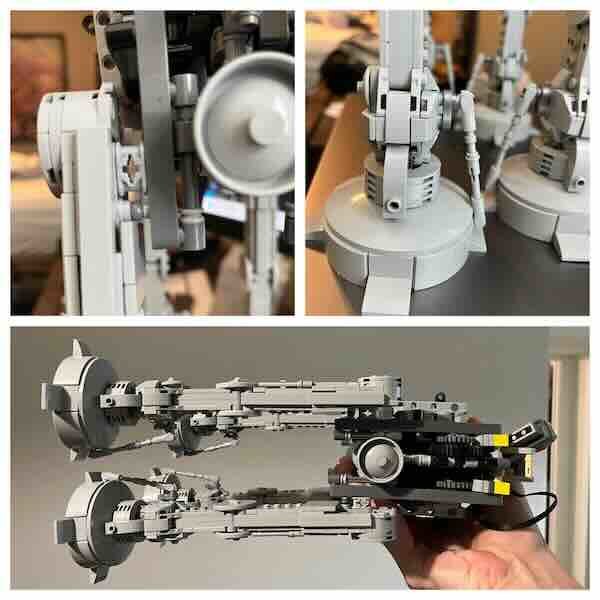

BrickBear Posted October 30, 2024 Author Posted October 30, 2024 (edited) On 10/30/2024 at 7:13 PM, Nelson said: Here are a couple more ideas that may help your cause. I too have the same issues with balance/leaning and sought to get some compensation in the feet and legs. I came up with a way of mating the external legs to their internal connecting rods with a small ball/bar piece wedged in between a stud-pin and round 1x1 plate to create a bit of negative camber (Image 1). I also utilized the ankle strut feature seen in the film models to get more negative camber from the leg to the foot. I made the struts just a bit too long for the distance so they push the feet out a bit crooked (Image 2). Also note that the feet/ankles on my model have very limited movement, probably less than 10 degrees. I found this essential to keep the model from pitching forward or backward and falling on its face or butt if the feet slid. Finally, you can see in image 3 that the model is quite rigid at all points during its cycle. If I hold the it sideways, the legs barely deflect at all. My early versions all started out pretty loose and I had to really lock things down. Of course, we are taking somewhat different approaches, which I find really intriguing, so these features may not be as necessary in your design. There was a post earlier in this thread that suggested a cam system that is very close to the concept I'm using (although I had already tried and failed with the parts he suggested and used a different method of creating cams.) Expand Mmm, I used a plate with rail to offset some of the lean. I’ve considered the inner rod as a point of support too, adjusting where the pins go too. If I may how exactly does yours work? Edited October 30, 2024 by BrickBear Quote
