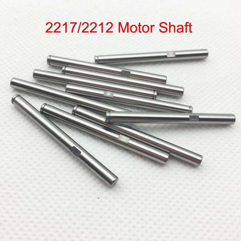

So what I did in my A2212 motor is I removed the shaft from it and then grinded it to the point it matched the groove that was already in it (below I attach photo of A2212 motor shaft with mentioned groove).
Brushless Motor 2212 Shaft | 2216 2217 Rear Axle Motor | 2217 Brushless  Motor - 6pcs - Aliexpress
After that, I put motor back together and attach first a half technic bush as a separator. Then, with a help of small cutted part of a credit card or any card I can attach any Technic part. In case of photo below I attached Lego 52731 part.

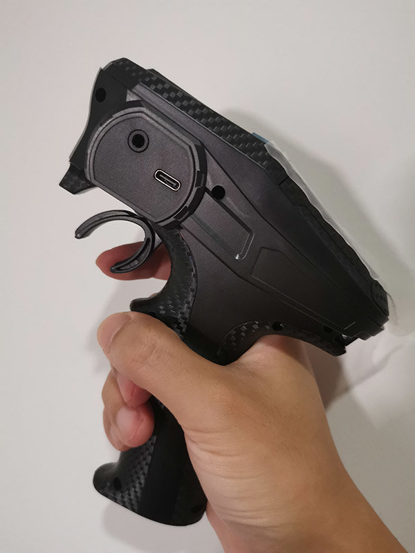

Thanks I had overlooked that. Unfortunately it's one of those ugly pistol shaped monstrosities (which I understand is widespread in RC but I just find them hideous and impractical for my little kids).. :-(
@Ryokeen @wower
I thought this conroller was cool enough, hahah, it seems I was wrong. If you have any recommended controller, please tell me and I will try to make some adaptations.

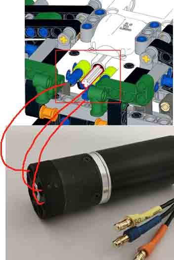

@gyenesvi The white part in the picture above is the differential, which is fixed through the frame and can be connected to the round hole of the motor.
So does that mean that the motor has two pinholes in the front? Are there only two? Or more? Can it be supported on the rear end as well? We need connection info for all parts.
Also sizes. What's the size of that motor (how many studs length/width/height)?
For the wheel hubs, what connections do they have? (pins, axles, U-joints), are they the same size / geometry as lego hubs? What rims can I attach to them and how? Things like these.
