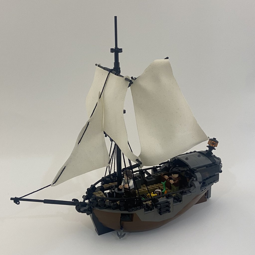

I recently built two ships designed by Moc Your Bricks. They are the Hancock Merchant Sloop and the Morton Imperial Brigantine. I think they are fabulous designs and I really enjoyed building them. Creating the custom sails was a totally new step for me. I wanted to break down how I did it in case anyone was intimidated by something new (as I was at first.)

I used the original paper templates to get figure out placement for hole punching. Once you finish all the sails, MOC Your Bricks has a YouTube video for each ship that shows how to rig them.
A8163B20-8DF3-49B5-8E61-83B2C005C83D
I find both of these ships to be simple yet pleasing to look at. They also offer something a little different from the standard Pirates/Bluecoats. I highly recommend adding them to your collection too!

Very nice ships, I especially like the brigantine. I like how you built the railing on the ship. The sails and rigging are well done. The instructions for making sails are also very interesting.

Good job on the sails, has a very natural, realistic look :pir-thumb:
