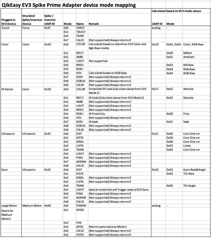

One major issue with the Mindsensor board is that the old sensors only work with Python and not the scratch based word blocks.  Also, because of voltage difference (EV3 runs on 5V, and Spike Prime runs on 3.3V), there is a good chance that you will run into power related issues.
Below is a new board that my friend and I worked on that actually do protocol level translation so that the EV3 sensors will be recognized as Spike Prime sensors.  This allows you to program your EV3 sensor in Word Block. The board is powered by an ESP8266 MCU.  As such, even EV3 motors work with this board.
https://www.qikeasy.com/
  On 5/19/2022 at 7:21 AM, joeh said:
... do protocol level translation so that the EV3 sensors will be recognized as Spike Prime sensors.  ...

What are the costs? Cable included?
Is it cheaper than a new RI-Motor (which has more options)?

We are in the last phase of finalizing the design of the board.  Once we are ready for production, we will put it up on Indiegogo.  It sounds like you are very interested in the product, you should subscribe so that you will get notified before our crowdfunding campaign goes live.  To get our product at discounted price, you can join the VIP program (the link to join the program will appear after you subscribe).  By joining the program, you will be able to get the product at these prices:
        Buying 1 unit @     US$20 each
        Buying 2 units @     US$19 each
        Buying 4 units @     US$17 each
        Buying 10 units @     US$16 each
Cable will be extra.  Unfortunately, we couldn't include it in the price, as the cost of the cable is expensive.  We will sell the cable at price similar to or lower than what you saw on the AliExpress page.
Comparing the cost of the the motor with the cost of the adapter isn't an apple-to-apple comparison.  With the motor, you only get one motor.  With adapter, you enable multiple types of EV3 devices that you already have (even though each adapter can only power one EV3 device at a time).
The emulated device IDs will be exactly the same IDs as the equivalent Spike Prime devices.
Regarding details of translation/emulation, that's going to take me a bit of time to prepare the table.  I will try to give you something later.
How Access EV3-Sensor Modes not "translated" ?
For the EV3 modes that are not translated, you won't be able to access them.  However, we believe we have translated pretty much all the practically useful modes.  So, I don't see that being a problem.  If you see that being a problem, I would like to know.
What is delivered when accessing PoweredUp-Sensor Modes not used for translation ?
... you would get 0's or some other meaningless values.
@BrickTronic  See attached table for device mode mappings performed by our Adapter board.
Expand
Thanks,
Your Table helped a lot to understand.
