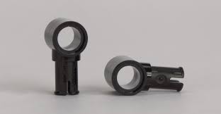

Name of the game is form locking. If you're relying on axle or pin connections not pulling out, it's not strong enough.
On each adjoining axle hole, put a 3L axle with stop through two of these guys, one above and one below the gear racks, pointing inward.
https://rebrickable.com/parts/42003/technic-axle-and-pin-connector-perpendicular-3l-with-2-pin-holes
That'll join your circles of 4 quarters, and now you have something to attach liftarms to, in the correct orientation so they're form locked.
Proviso: I don't have any of those gear racks, so idk if the 3l perpendicular connector is long enough.

Hi,
This is actually how I did it, indeed, I used 3L friction pins, 15L liftarms, 3x5 bent beams and those connectors.
Maybe this is the best way after all
Seems like the minimum parts you need, to make it form locked.
