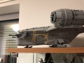

Mace Handowan Posted February 28, 2021 Posted February 28, 2021 On 2/28/2021 at 10:16 AM, Jerac said: Looking good! So glad you like it. You can fold the 1x1 tiles on the turbines' fronts way more inside, the edge will be nicier. Something like here: Expand Thanks for the tip. Will do 😊. Any ideas regarding my two questions above? Quote

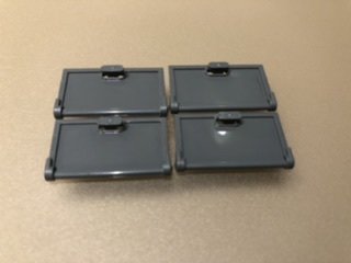

Mace Handowan Posted February 28, 2021 Posted February 28, 2021 (edited) On 2/28/2021 at 11:19 AM, Jerac said: Sorry, I didn't notice them! Alright so: - Yes, the lights are supposed to be on when sliders are pushed in. Unfortunately, those light bricks are notorious for having issues. If the rear one is acting up you're lucky, since this one is easier to remove. Try doing so, unscrewing it, cleaning everything inside and installing again. There's not really much place where the sliders can got in terms of misalignment. - Could be, though I never encountered this. Can you show close up photos of the doors handles and the ramp piece? Maybe I can spot something off. Expand Thanks for the quick reply. Interestingly, the light brick fully lights up when the lever system is pushed in a certain angle. But yeah, probably have to get this thing out. Also needed to do this with one of the front ones. There, the problem was the switch needed to go in all the way so that the contact to both batteries was made. Here, I bent the metal contact a bit so that the light goes on with minimal press of the switch. Probably have to do this for the rear one as well 🙁. Really unfortunate as I checked everything multiple times during the build. As for the doors, I included a close-up view. As already mentioned: The door pieces will simply not stay in place. Do they need to be slightly rotated? Edited February 28, 2021 by Mace Handowan Quote

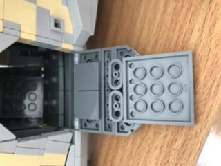

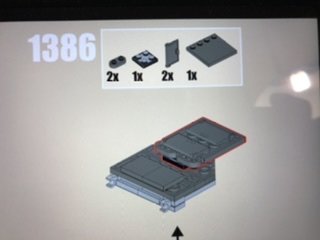

Jerac Posted February 28, 2021 Author Posted February 28, 2021 Hmm, regarding the door pieces, the angle should not matter. You are attaching them to a circle after all. You can check if they can be attached to the bottom of any 2xN plate. If they can, then your 4x4 tile is faulty. If not - the door pieces. Also they have to be pushed in quite strongly; this is not an "official" connection. Btw can you link your ramp piece photo in a way that I can see it in full resolution? It is too small for me right now to detect any irregularities in the tiles' bottoms. And I'd also need a photo of the doors' handles. Quote
Mace Handowan Posted March 1, 2021 Posted March 1, 2021 (edited) On 2/28/2021 at 11:38 AM, Jerac said: Hmm, regarding the door pieces, the angle should not matter. You are attaching them to a circle after all. You can check if they can be attached to the bottom of any 2xN plate. If they can, then your 4x4 tile is faulty. If not - the door pieces. Also they have to be pushed in quite strongly; this is not an "official" connection. Btw can you link your ramp piece photo in a way that I can see it in full resolution? It is too small for me right now to detect any irregularities in the tiles' bottoms. And I'd also need a photo of the doors' handles. Expand Will try to link the photos of the ramp piece and the doors‘ handles. Regarding the lighting system: Are the levers really supposed to stay in after being pushed to activate the lights? And one more question: When standing on its landing gear, is the model supposed to stand perfectly straight? Because mine has a slight angle (front side being lower than the back side)? Well, linking the images won‘t work. My old Photobucket account has been shut down. Here is an image of the doors in low resolution. Nothing suspicious to be seen. Edited March 1, 2021 by Mace Handowan Quote
Jerac Posted March 1, 2021 Author Posted March 1, 2021 Yeah it might lean a bit to the front. That said, did you receive v84 update? It fixes one issue with front landing gear which can cause it to sink too deep. Basically two 1x4 plates need to be added. Lightning - yes, the levers are supposed to stay put. You slide them inward by about a stud and then have to pull them out. And you need to do it with quite a lot of force, there's a lot of friction there. As for the doors, well, I can't see anything wrong there either. If more people will report issues with that I'll just remove them. This is a non-critical detail. Instead of photobucket try imgur; works like a charm for me and you can just ctrl+v a a link and it will automatically embed here. Quote

Jerac Posted March 1, 2021 Author Posted March 1, 2021 As far as I know v84 was sent to everyone, just checked. Please check your e-mail, possibly spam folder? If not send me a PM. Most of the fixes were to the instructions themselves, some clarifications and minor adjustments here and there. Changelist: - wedge belt wheel in pdf part list had wrong part id - some 1x1 plates were incorrectly rotated in the engines - step 939 had diagram showing 1x1 corner 2-stud piece, while it is a 1-stud piece - a hose parts list in step 1048 incorrectly had parts list showing (for this step it should be disabled entirely) - two plates near front landing gear were missing - front right opening panel (with gun rack) had additional hinge top which caused the doors not to be able to open fully Quote

Jerac Posted March 2, 2021 Author Posted March 2, 2021 On 3/2/2021 at 9:42 AM, Lfm55 said: The official set looks so miserable aside the moc :D As i won’t be building the stand, thanks for your picture of the front landing gear, It might helps when i will finally be building mine (hurry up lego brick n pieces!). The one in the build looks somewhat fragile to support such a big ship. I’ll try first the v84 solution and if i am not satisfied, i’ll use your mod. Expand The ship rests only about 5% of its weight on front leg: (this weighs only one rear leg, so there's 1.4 additional weight in the back). Also with the 1x4 plates added in v84 the load is passed through angled plates and the skip right to the ship's lower frame, so flimsy-looking droid arm is not doing anything in regard to weight transfer. Even if it had to, 120 grams of force is not much :) Quote
