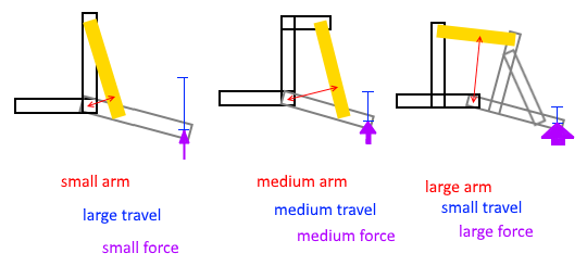

Didumos69 Posted November 28, 2020 Posted November 28, 2020 (edited) On 11/26/2020 at 5:02 PM, amorti said: Try again using normal 6L wishbones, and mount a single shock inside their split. The lower mounting of the shock will reduce the leverage the wheel has over the shock, increasing the stiffness of the spring. Expand Alternatively, you can make the suspension arms and the steering links 9L. Btw, there's 2 simple rules when it comes to suspension stiffness and travel. 1. The percentage by which a given weight compresses the suspension is roughly defined by the distance of the shock and the rotation point of the suspension arm to which the shock is mounted. The closer the shock to the rotation point, the less weight it can carry. 2. When extending the suspension arms while preserving the aforementioned distance (keeping the shock mounting points the same) the same weight will give the same compression percentage. So by extending the suspension arms, you increase suspension travel without declining the weight the suspension can carry. Therefore I say, make them long if you want travel. Courtesy by @Erik Leppen. Edited November 28, 2020 by Didumos69 Quote

Erik Leppen Posted November 28, 2020 Posted November 28, 2020 On 11/28/2020 at 6:30 PM, Didumos69 said: So by extending the suspension arms, you increase suspension travel without declining the weight the suspension can carry. Expand No, it does not. Increasing the travel will always decrease the weight the shock can handle. This is because a shock can handle only a certain force (not weight) - namely, the force your fingers exert when compressing the shock by hand, without any levers. If you increase the travel, then the same force (or energy?) is used to push the vehicle up by a greater distance, meaning the vehicle has to be lighter. (I'm sure there is a physicist that can explain this using the correct units.) You can easily test this theory by using an extreme example: if you would make the suspension arms 10 times as long, you'd discover that the suspension cannot lift your vehicle 20 cm up :) (if it somehow can, add more zeroes to these example numbers until it fails :P ) Quote
Didumos69 Posted November 28, 2020 Posted November 28, 2020 (edited) On 11/28/2020 at 8:34 PM, Erik Leppen said: No, it does not. Increasing the travel will always decrease the weight the shock can handle. This is because a shock can handle only a certain force (not weight) - namely, the force your fingers exert when compressing the shock by hand, without any levers. If you increase the travel, then the same force (or energy?) is used to push the vehicle up by a greater distance, meaning the vehicle has to be lighter. (I'm sure there is a physicist that can explain this using the correct units.) You can easily test this theory by using an extreme example: if you would make the suspension arms 10 times as long, you'd discover that the suspension cannot lift your vehicle 20 cm up :) (if it somehow can, add more zeroes to these example numbers until it fails :P ) Expand You're right that the shocks can only handle a certain force. But I don't think you're right about the travel. You have to see it this way. It's not the arm that applies force, it's the car's weight that is the source of force. How much force the car applies to the shock with it's own weight, is defined by the geometry made by the mounting points of the shock relative to the car, not relative to the outer ends of the suspension arms. With longer arms, while preserving the exact same geometry, the weight will still apply the same force on the shocks and only make the arms articulate more, but not compress the shock more. So more travel yes, more compression of the shock no. Of course in practice the weight of the suspension arms is going to play a role too when they get very long. But when we talk about 9l suspension arms or 6l arms, that effect will be negligible. So I still arrive at the conclusion that longer arms don't affect how deep the car sinks in the springs under it's own weight, while they do increase travel. Edited November 28, 2020 by Didumos69 Quote
amorti Posted November 28, 2020 Posted November 28, 2020 In real vehicles, suspension springs are measured in kg/cm. Or, how much weight it takes to compress the spring by X amount. There's no other wizardry in a spring: apply a certain force and it'll compress a certain amount. So it follows that if you get more travel, you certainly do have softer suspension as the trade off. Quote
Didumos69 Posted November 28, 2020 Posted November 28, 2020 (edited) On 11/28/2020 at 9:18 PM, amorti said: So it follows that if you get more travel, you certainly do have softer suspension as the trade off. Expand Yes softer, but the car's weight will compress the springs just as far as with shorter arms. Suppose you have 6l suspension arms (5l center to center), you have travel of 2 studs and the car sinks in its suspension by 1 stud (50%). Now when you extend the suspension arms to 9l (8l center to center), while preserving the exact layout of the springs, you get roughly 8/5 times the travel (>3l) and the car still sinks in its suspension by approximately 50%. This is of course under the assumption that the weight of the suspension arms is only a fraction of the car's complete weight. Edited November 28, 2020 by Didumos69 Quote

amorti Posted November 28, 2020 Posted November 28, 2020 On 11/28/2020 at 9:29 PM, Didumos69 said: Yes softer, but the car's weight will compress the springs just as far as with shorter arms. Suppose you have 6l suspension arms (5l center to center), you have travel of 2 studs and the car sinks in its suspension by 1 stud (50%). Now when you extend the suspension arms to 9l (8l center to center), while preserving the exact layout of the springs, you get roughly 8/5 times the travel (>3l) and the car still sinks in its suspension by approximately 50%. This is of course under the assumption that the weight of the suspension arms is only a fraction of the car's complete weight. Expand Yes then we do agree, because the same weight is being applied to the spring so it compresses the same amount of its travel. Or at least it sounds right. I feel like I'd need to build a test rig which took that to extremes, to actually prove it to myself. Quote
