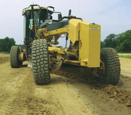

howitzer Posted November 16, 2020 Posted November 16, 2020 16 hours ago, wguarnere said: I don't know exactly how is it called, but i know why he use this system: "When the motor grader is in the crab mode, the front axle is no longer running perpendicular to the direction of travel. This places one front tire slightly ahead of the other and allows one tire to be on top of a corrugation while the other is in the bottom. As the tires roll up and down through the washboard, the front axle will pivot up and down keeping the front mainframe stable. " If I understand this right, it means that the chassis is articulated just behind the cabin, am I correct? Quote
wguarnere Posted November 16, 2020 Author Posted November 16, 2020 59 minutes ago, howitzer said: If I understand this right, it means that the chassis is articulated just behind the cabin, am I correct? Exact like that : Quote
