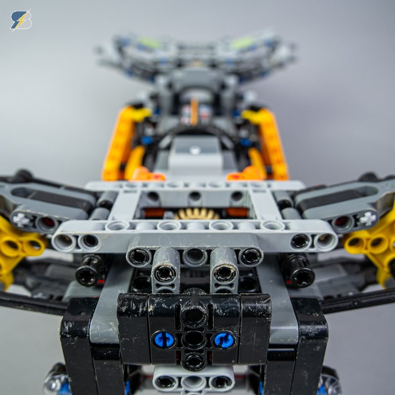

Finally took the time to write a few words about this model!
First, photo and video...
Rocky is very nice version of the crawler, with an innovative suspension system. As you can see on the video, the climbing capability is excellent. I liked a lot the photo steps building instructions (and from a LDraw aficionado like me, this is a big compliment ;) ). The model is compatible with LEGO app but works fine too with BC2 or Controlz. Some drawbacks now: accessibility to the "on" button of the hub is not wonderfully handy (but the procedure is well documented in the BIs). The wheelbase is 30% longer than official model, which means that the turning radius is very poor. Speed is slow too, the price to pay for the agility... but I dream of a model with a two speed gearbox controlled by a 4th motor!

Thank you @Philo, for sharing your experience. Great to know the instructions are workable. The model is slow, by design obviously, and yeh, the turning radius is quite poor. Maybe I have been too protective towards the new CV joints. I have been in debate whether to drop the levers tying together the upper and lower suspension arms (the black and yellow levers), but thought it would serve two goals, a stronger setup and a limited steering angle, which implies more protection for the CV joints. However, the model can do without the levers, because the tow balls and wheel hub are one piece (so now tow balls can pop out) and downforce is only applied to the upper suspension arm. Long story short, you might try to improve the turning radius by dropping the black and yellow thin levers close to the wheel hubs. You will also need to recalibrate the L-motor for steering of course.
Btw, I'm curious to know what you think of the rigidity/robustness of the whole model.
