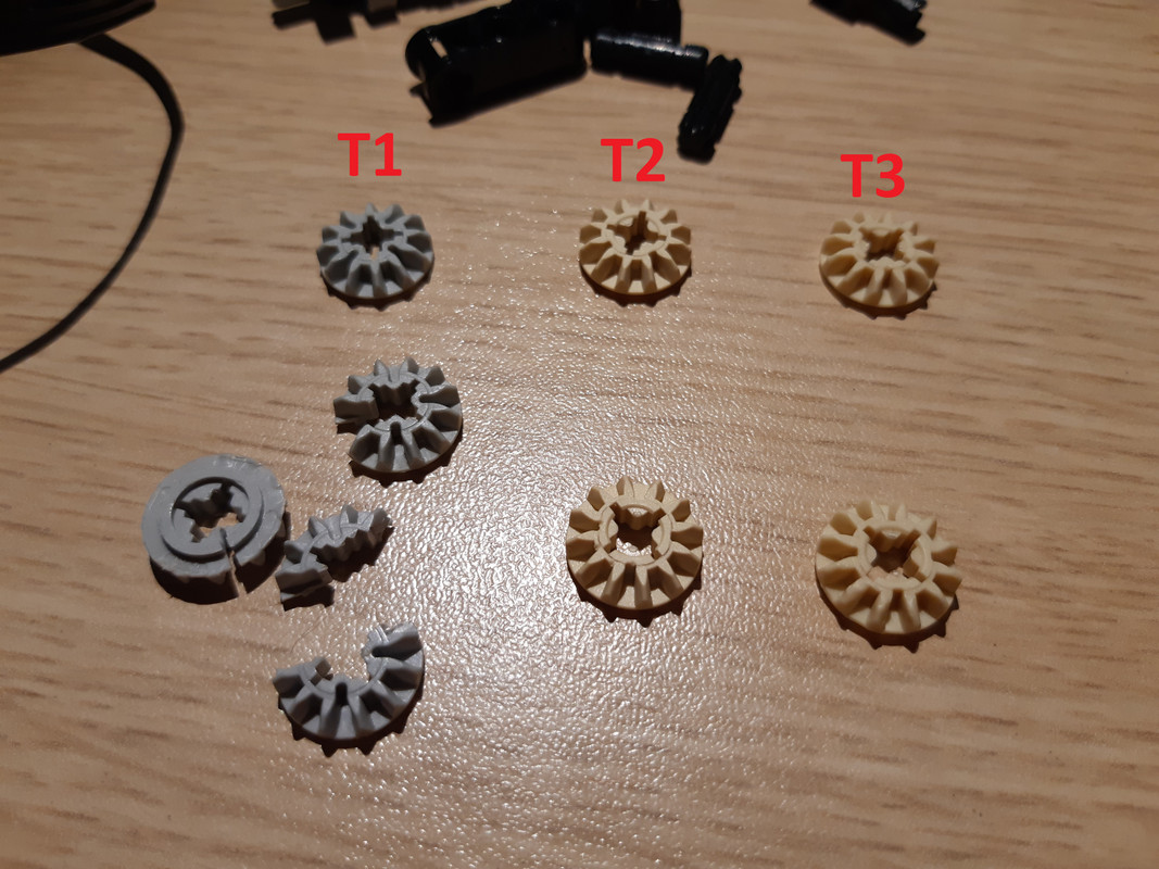

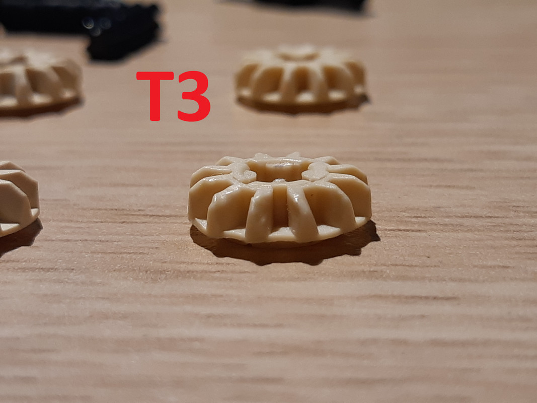

amorti Posted April 23, 2020 Posted April 23, 2020 On 10/9/2019 at 4:54 AM, weavil said: I took a few pics of a couple12 tooth bevel gears I had. The old one is on the left and the newer is on the right. The left is darker ... Expand For me this first picture shows not that the older gear is a lighter colour, but that there's more material in there and the light couldn't penetrate. Which matches the second image because you can see the centre of the gear is recessed just a little. This explains why I have two pairs of these gears in the rear axles of Didumos's Greyhound, which have become loose on their 5.5 axles. Worth noting the gears are pretty much at the edge of their capability in this application, being driven 1:1 by a buwizz powered L motor each. I haven't taken it apart yet to check if the axle is wearing/compressing or the gear is wearing/stretching, but a reduced contact area between the two pieces would be a cause either way. Has anyone got busy with a cleaver, and cut a 12 tooth double bevel gear in half? If so was it stronger? Quote
syclone Posted April 23, 2020 Posted April 23, 2020 Well, not a cleaver, but new new 12T half-width gear seems to be made from a softer material, as I could score it quite deep with a fingernail. (the older one also gets scored, but much less, new one is veeery soft). The "antique"? grey gears I wasn't able to create visible scratches with nails, as they are made from much harder and therefore brittle material. So we went from brittle gears to very soft gears. This would explain why I started getting "chewed up" gears instead of broken ones. Quote
Zerobricks Posted April 23, 2020 Posted April 23, 2020 I noticed the same behaviour. I think it's safer for gears to be chewed up than to fragment and fly away. Quote
Gray Gear Posted April 23, 2020 Posted April 23, 2020 (edited) On 4/23/2020 at 7:05 PM, Zerobricks said: I noticed the same behaviour. I think it's safer for gears to be chewed up than to fragment and fly away. Expand In a motorized model that might be good thing, but In a manual model with almost no friction i would rather have hard gears, because I can be sure they won't wear over time. There is no chance of them breaking anyways. I recently bought used old lbg gears on purpose, they feel much more solid and run way smoother than my also used tan ones. And without color vomit everything looks way better anyways Edited April 23, 2020 by Gray Gear Quote
