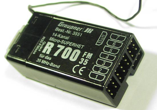

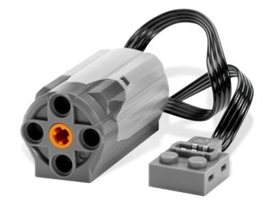

Wojtulson Posted September 30, 2019 Posted September 30, 2019 (edited) Hello there! I'm looking for the information is there a way to easy connect and control the standard Lego Technic motor e.g. 8883 M-Motor: with a classic RC receiver e.g. this 35mhz Groupner: I understand that between these two parts should be some kind of esc/controller? Could you give some tips how to find the right component? Thanks! - Wojtulson PS: and of course there should be a power supply connected to the esc/controller. Edited September 30, 2019 by Wojtulson Quote

sirslayer Posted October 11, 2019 Posted October 11, 2019 I've found the instructions and it shows a few configurations.. The problem is its only 4.8 volts output or add an amplifier that adds up to 7.2 volts?? I don't know if 4.8 volts can drive a M size motor?? Here is a link to the pdf file https://www.graupner.de/mediaroot/files/4713_X_412FM_de_en_fr.pdf Quote
ben20 Posted October 12, 2019 Posted October 12, 2019 (edited) On 9/30/2019 at 3:39 PM, Wojtulson said: Hello there! I'm looking for the information is there a way to easy connect and control the standard Lego Technic motor e.g. 8883 M-Motor: with a classic RC receiver e.g. this 35mhz Groupner: I understand that between these two parts should be some kind of esc/controller? Could you give some tips how to find the right component? Thanks! - Wojtulson PS: and of course there should be a power supply connected to the esc/controller. Expand When you use a rc receiver you always need a esc to control your motors. This because you have 3 pins/wires (- + signal) and the motors consume more voltage the receiver can handle (it is possible without, but only for small applications like lights and servo's) In my loader i use a mix of Lego motors and rc ones, together with lights sound, etc. The options are endless what you connect to it On 10/12/2019 at 10:03 AM, ben20 said: Expand Edited October 12, 2019 by ben20 Quote
