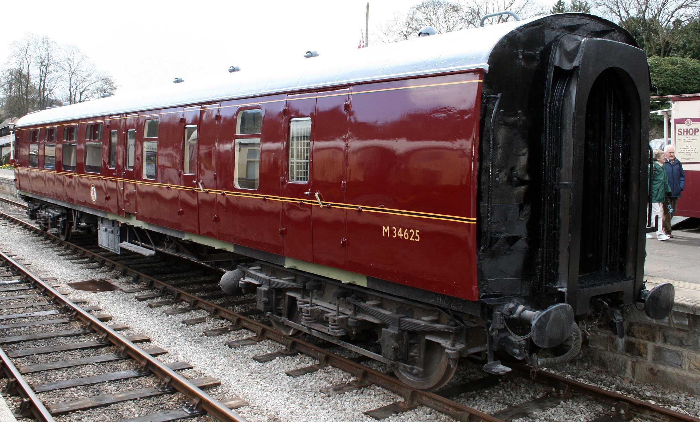

Below is a diagram of a BR Mark 1 BSK (Brake Standard Corridor), i.e. a Guard's coach, that I've shamefully pinched from a google image search.
Suitable Donors for CIE MK1 BSGV - Questions & Answers ...
The guard has their own compartment; it houses a swivel stool, handbrake wheel, shelves, and periscope mirrors to see along the roof of the train (I never knew about that last one!). The compartment also has it's own inward-opening doors, one in the compartment and one directly opposite; these are the only doors on a train that can open if it's stopped in a tunnel, next to a wall etc.
Adjacent, and with a window in the wall between it and the guard's compartment, is the open area with double doors for luggage; you've modelled this area pretty much spot on. I don't think the barred windows are strictly accurate, but they look good so I'd keep them. I also don't think the window should have blinds, but if you like 'em, keep 'em. At least swap the windowed and non-windowed doors around; the windowed one is always on the left (looking directly at them from outside, both sides).
It's clearly not possible to fit all of the doors and windows onto your model; selective compression is the order of the day, and you've done a fine job with that so far. Your overall train so far (CK + BSK) already looks very pretty; perhaps an SO ("standard open", i.e. no compartments) next?

The white blind is indeed only used on lavatory windows - perhaps I'll remove that as I continue to tweak my model. I will not add extra doors for the guard's compartment, but adding periscopes is an interesting touch (and who doesn't want to add 2 LBG cheese slopes to a model?). I could theoretically move the break wheel more to the center of the carriage, but then I will not have a lot of space to put the little trunks and other luggage .... perhaps I just leave it where it is and pretend.
I don't think I will build an SO, simply because it doesn't seem to feature in the Potter movies and books. I will double up on the CK instead, maybe label one as 2nd class .. I've got the tiles ready for that :)
