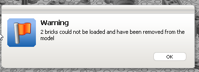

Tested on last .lxf and got error:
Yes, could be true. Those files will be re-added in the next update (it's a helmet and the mini doll head).
