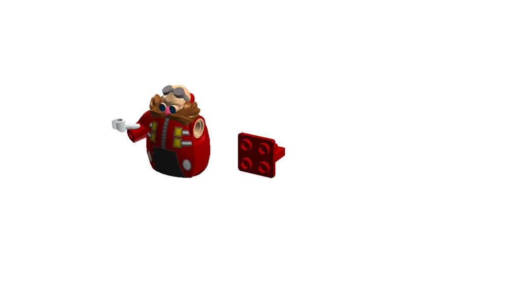

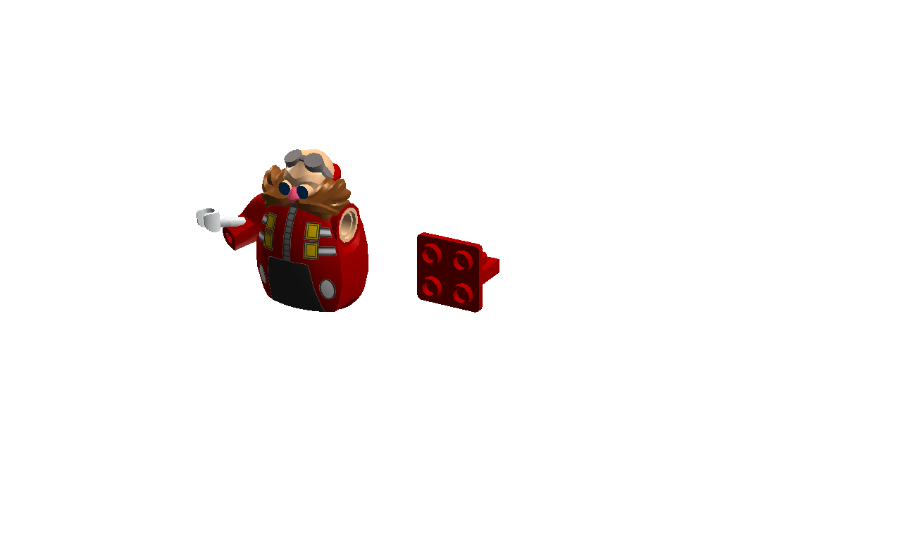

Takanuinuva Posted August 6 Posted August 6 8 hours ago, anothergol said: Loving the latest update. Anyone knows which set the new 7674 bracket is from? Can't find anything about it online I was just about to ask the same question but also share that the arm used on Eggman is bugged in that the hand doesn't rotate with the arm. Also the fact that the inside of his torso is supposed to be red and not tan. Quote
