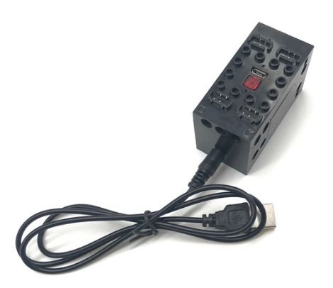

amorti Posted March 21, 2020 Posted March 21, 2020 550mah isn't much. Anyone know just what type of battery that is? And what capacity you could get for a sensible investment? Quote
Jimrask Posted April 13, 2020 Posted April 13, 2020 Does anybody know if it's possible to put 2 of those bricks in series to double the voltage? Quote
amorti Posted April 13, 2020 Posted April 13, 2020 I think putting 14.8v into a 9v motor wouldn't end well if you did figure out one way to make that work. The question you should rather ask is if anyone knows enough electronics to look at the MouldKing box shown above (it's taller and has some wasted space inside) and tell you if a 3S 11.1v lipo would melt any of its components. Buwizz 2 gives 11.1v, so I assume it has a 3S inside, but as you know by the price of it, the parts inside are simply better quality. The other other question you should be asking, is if it's really a good idea. The cheap boxes have digital steering only: left, centre(ish) or right. That is barely enough control for the speeds you'll get with 7.4v. if you ramped that up to a higher voltage without improving steering control... Well, I can tell you from experience that it wouldn't be much fun to drive your creations. Quote

fosamax Posted May 2, 2020 Posted May 2, 2020 Hi, my first cada battery is now broken. Only one port is working fully and one is working in only one direction. Did anyone succeeded in replacing the mx1616l chip ? I saw that mx1508 is more available. Could it be a viable option ? There's not any sign of defect when I open my battery box so it's not easy to guess what to try. Will probably go with buwizz but I would be happy to fix those, at least for children. Quote

roeleman Posted May 26, 2020 Posted May 26, 2020 (edited) On 5/2/2020 at 9:16 PM, fosamax said: Hi, my first cada battery is now broken. Only one port is working fully and one is working in only one direction. Did anyone succeeded in replacing the mx1616l chip ? I saw that mx1508 is more available. Could it be a viable option ? There's not any sign of defect when I open my battery box so it's not easy to guess what to try. Will probably go with buwizz but I would be happy to fix those, at least for children. Expand Hello, I had to change the motordrivers. I didn't found the mx1616l but I did find the mx1616. I replaced it and it worked, but I think I messed up my soldering because not all functions worked. So I tried resoldering everything but I probably burnt something as my remote wouldn't connect with the box anymore. So if you are good in soldering small stuff, it's worth trying. Shame the CADA box is such a bad quality. I had 2 of them and both are already dead. You should expect more from a company that makes mostly RC stuff. There is now another brand with a similar looking box like CADA, search for MOFUN on banggood. It"s a Toyota Trueno, it has also a small motor to move the lights. Maybe it's better then the Cada. Edited May 26, 2020 by roeleman Quote

dnsrsv Posted June 2, 2020 Posted June 2, 2020 Guys, the cada power supply fails when overloaded, as buwizz goes into defense. But cada, unlike buwizz, does not return to normal operation after that, it stops responding to some of the buttons on the remote control. Empirically found a way to restore it - you just need to reboot it. True, for this you need to disassemble it, and solder the power wires from the board, and immediately solder it back. How to de-energize for a short while. After he begins to work like new. I did this repeatedly with my unit, I came to the conclusion that you should not use it without a differential. Quote
fosamax Posted June 2, 2020 Posted June 2, 2020 I'm in the process of trying to fix one of mine. There's no sign of burned component in mine so your fix could apply. Anyway I don't understand what you've done. Could you please explain a bit more or post photos (hosted at bricksafe or flickr) of your fix ? Quote
AVCampos Posted June 2, 2020 Posted June 2, 2020 If I understood correctly, he de-soldered one of the wires going from the battery to the main board to fully power it down, then soldered it again to restore power. A kind of very hard reboot. Quote
ace_klimax Posted June 2, 2020 Posted June 2, 2020 On 6/2/2020 at 9:10 AM, dnsrsv said: Guys, the cada power supply fails when overloaded, as buwizz goes into defense. But cada, unlike buwizz, does not return to normal operation after that, it stops responding to some of the buttons on the remote control. Empirically found a way to restore it - you just need to reboot it. True, for this you need to disassemble it, and solder the power wires from the board, and immediately solder it back. How to de-energize for a short while. After he begins to work like new. I did this repeatedly with my unit, I came to the conclusion that you should not use it without a differential. Expand This gives me hope, based on this comment i decided to open battery. After unscrewing all 4 screws i had to depart light and dark grey part, that were tightly glued together. Insides looks without burn or anything bad, so i'll try to solder one of battery wires from mainboard. If i'll solve the issue i woud think, for the future, to implement there some small switch accessible from outside of the box, ideally in the top center space let's see drsrvs thanks for sharing your workaround Quote

fosamax Posted June 2, 2020 Posted June 2, 2020 I furthered tested mine (didn't received the motor driver yet) and for sure the failure is only partial. I tested it by pluging a lego receiver on it and 3 of the ports are supplying power, even those that don't work when pluging a motor directly. I have one that doesn't work that way either. Quote

swgt Posted June 2, 2020 Posted June 2, 2020 I have discovered that plugging in a lego buggy motor into the cada battery box is a very bad idea. The box is dead. Speaking of buggy motors, the Chinese are now making copies of buggy motors (the only difference is that there is a cable that ends with a PF standard interface). They are fast and drain batteries like there is no tomorrow. I have gotten two off ebay for about $US 15 each. I wonder if the same or similar motor is in the Mould King L-motors. Quote
