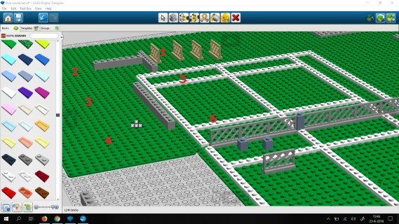

This was totally new for me and I start with an easy plan. But I have some problems with de base of my plan. It looks like de base had 1 level lower than the other one.
So I can not place a brick on the place I want. I have market them with a red pilon so you can see what I mean.
Is it possible that someone wil have a look and wil tell me what I do wrong and how I can fixe it?
I have an attachment uploaded here.

Until now I have not been able to solve the problem. The entire outside of the tenniscourt is 1 level too low.

I have delete the whole green outside and started again with a coppy of the green base from 3 and 4.
                 I have an attachment in this topic of my screenshot for asking my questions.
Number 1 and 2 are correct (see the grey brick)
The two grey bricks at 3 and 4 are at the same high because I see no differents in level of the bricks
But I can not place a brick on the border between 3 and 4. (see the virtual try)
It is a mirracle for me but I am a beginner. What is the problem here. I suggest that its me!!!!
can you help me?
(Re)Move the baseplate, put the bricks that should join the baseplates, add the baseplate back, it will connect with the bricks and be at the right height / the same height as the other baseplates.  You can then remove the bricks if you don’t want them (in that case, they are called “scaffolding bricks”: they just serve to place other parts).
The “ground” is where the lowest part is.  If you have parts lying around that are below the baseplates, any new baseplate will go on their level, not the other baseplates’ level.
It’s easy to have this problem.  Putting parts on the ground, unconnected, will often lead to this.  When you do complex builds, you need to remember to connect your parts (as it’s done in official instructions for instance), not put two parts way apart and then hope the parts you pile on each side will then gently connect when they meet.  They should connect but, as you experienced, sometimes they don’t because you forgot one part somewhere or miscalutated or a part was misplaced or rotated and it moved the ground down.

Is it an solution when I go through my entire project and see which baseplate are different from the others? And in the following way.
I take 1 brick and put them on each plate on the borders in the North, South, East and West. When that is possible the baseplate is on the corrrect level. If not, I delete him.
But. I think I have to remove all the bricks who are on the wrong baseplate. Is this right?
Greatings of Holland.
Expand
Your baseplates are not aligned because you placed them in different moments when the "ground level" was different.
So, when you build a new model, you have to be careful that the ground level don't change or that the new plates will be connected to something at the right level (for example a brick temporarily placed across the old and the new baseplate).
Anyway this time you have to deal with an existing model, and I suppose you want to avoid to build it again from the scratch. If now you have understood how thing works, you should be able to fix the problem using the procedure I described you above. Ok, it is a little more complex because there are so many baseplates, but the main concept is the same.
PS: I've seen you used many baseplates in your project. Note that LDD can't manage an infinite number of bricks and have specific difficulties with baseplates. So be careful with your creation or LDD will have troubles to run it very soon.

I could also perform the actions but without result.
The comment that I once put pieces outside the baseplate were correct.
And if I put bricks there then it goes wrong.
What have I done? I created a whole new base plate next to my project.
Everything removed except my house etc and then copied to the new base plate.
Now everything has the same level and I can continue.
Thanks for the tips because they helped me understand what I should look out for in the future.
