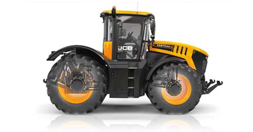

1gor Posted December 23, 2023 Author Posted December 23, 2023 (edited) After some (longer) time, I have something new; thanks to genius @Zerobricks I decided to take another chance for narrow steering axle using (Daytona) differential and planetary hubs, so here is a result Since original tractor has 4 link suspension at front, this axle could be the solution for 1:18 scale Fastrac 8330. Steering angle is acceptable even with wide balloon 94.8 x 44 wheels (no tire rubbing), but with upcoming 94.3 x 38 (CADA) tractor tire it would be perfect (less than 20 studs overall width over tires). Perhaps I would have to lower shock absorbers or hide the more inside bonnet... Real tractor as template... @Jim I don't know if it is appropriate to post link to this post in Axle collection tread. If you find this is acceptable idea, I'll post there. Edited December 23, 2023 by 1gor Quote
