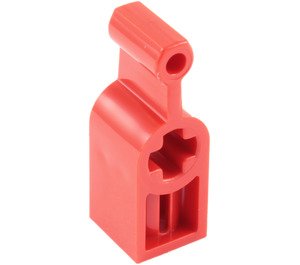

Zerobricks Posted June 4, 2019 Posted June 4, 2019 You could use the gearbox changeover arm to push the balls up the ramp and still have it freely fall down on the axle. Quote
Great Ball Pit Posted June 5, 2019 Author Posted June 5, 2019 On 6/4/2019 at 11:42 PM, Zerobricks said: You could use the gearbox changeover arm to push the balls up the ramp and still have it freely fall down on the axle. Expand What is the part number for the "changeover arm"? I'm not familiar with that name. Quote
doug72 Posted June 5, 2019 Posted June 5, 2019 On 6/5/2019 at 4:49 PM, Great Ball Pit said: What is the part number for the "changeover arm"? I'm not familiar with that name. Expand This part:- LEGO Change-over Catch (6641 / 19437) Quote
Great Ball Pit Posted June 5, 2019 Author Posted June 5, 2019 Thanks Doug! I'm not sure if this would improve performance over the Technic connector that is currently used, but it's something we could test out. Quote
dunes Posted June 5, 2019 Posted June 5, 2019 tried it with that piece and it failed. 1st the axle hole is loose. need to have two half bushes in front and back. and 2nd it wont slide over the top of the slide.. it hangs there. I stay with the proven and optimised design Quote
skppo Posted June 6, 2019 Posted June 6, 2019 I think Zerobricks meant that use the catch as the sliding part on the rotating vertical axle, not the actual pusher. This would eliminate the need for the other vertical axle. Quote
Zerobricks Posted June 6, 2019 Posted June 6, 2019 On 6/6/2019 at 5:11 AM, skppo said: I think Zerobricks meant that use the catch as the sliding part on the rotating vertical axle, not the actual pusher. This would eliminate the need for the other vertical axle. Expand Exactly! Quote
dunes Posted June 6, 2019 Posted June 6, 2019 (edited) Tried it this way. Won't work either. Too much friction. Its not sliding up. Finished in black and yellow. Edited June 6, 2019 by dunes video added Quote
Zerobricks Posted June 6, 2019 Posted June 6, 2019 On 6/6/2019 at 9:07 PM, dunes said: Tried it this way. Won't work either. Too much friction. Its not sliding up. Expand That's a shame, I think it needs a counterweight so it doesnt lock up. Quote
