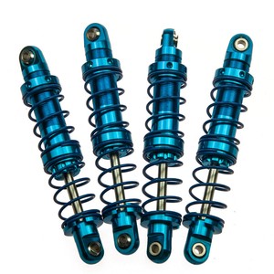

agrof Posted June 6, 2018 Posted June 6, 2018 (edited) I am a bit involved in RC business lately, and I was always wondering about using RC shocks with LEGO, example: https://www.ebay.com/itm/4pcs-70mm-aluminum-shock-absorber-Set-for-rc-rock-crawlers-CC01-D90-SCX10-/311703830304 In theory they could work, adjustable, for LEGO You don't even need to care about filling them with oil. I have 90 and 100 mm long shocks at home, maybe without the pivot balls (can be popped out) an axle would just fit through, I need to check. Edited June 6, 2018 by agrof Quote
Ivan_M Posted June 6, 2018 Posted June 6, 2018 No need to be as extreme as that. I have bought only 3rd party springs and shocks with soft springs, in the end each was less than 1€ in total. Quote
agrof Posted June 6, 2018 Posted June 6, 2018 @Ivan_M Now that is a brilliant idea! Can you please share what parameters (length, diameter, strength) the spring should have, what we should ask for? Quote
Ivan_M Posted June 6, 2018 Posted June 6, 2018 You have to aim for similar dimmensions - length around 45mm, overal diameter around 10,5mm, wire thicness around 0,8-1mm and of course force. If I remember correctly the total travel of 9,5L spring is 10mm and extra hard spring need around 1-1,2 kg to be compressed fully. So you need spring with R~1N/mm. Quote

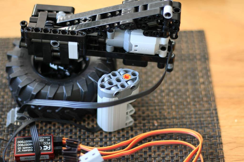

piece Posted October 9, 2018 Posted October 9, 2018 (edited) Yes, I used your latest lxf as my basis and imported that into stud.io. Then I made some changes to fit my needs. For example attached is an image how i reinforced the swing arms and changed the gears. I'll iterate on this to get it somewhat cleaner. But for the moment this seems stable enough. The gears in your version broke within the first 10 seconds in my setup. I use a proper RC remote and built a little circuit to control the motors smoothly. You can also see the center position of my servo. Maybe I should go to the lego store and demand a replacement. I bought it brand new recently. I'm looking forward to find out how you put the swing arms together. I honestly have no idea how you've managed that. If you look closely at the image, you'll see that I have to put some pins through the lift arm into the motor from the outside. As a result, I have to push the wheels 1 stud further out. That's not optimal. Edited October 9, 2018 by piece Quote

piece Posted October 9, 2018 Posted October 9, 2018 No, I had to remove the 48496. There was not enough room for that. Driving with the small gears should be not much of a problem. But when I blocked a wheel for a fraction of a second, it immediately burst into small pieces. The double bevel gears do not break so fast when the wheel gets blocked. After all i use a 11.1V battery which gets down to about 9.5v after the circuit stuff. It reacts a lot faster then any Lego or buwizz remote. Quote
