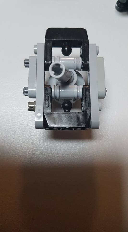

Didumos69 Posted April 13, 2018 Author Posted April 13, 2018 (edited) Thanks @kozso198700! I actually tried this, but with the turn-table wheel hub. Eventually I preferred the setup with 3L thin levers, because of their axle holes. They make a more stable hub alltogether. Btw, the main reason to have these complicated wheel hubs is that they incorporate the turn-tables and allow for the use of U-joint which can make a much sharper angle than CV-joints. I see you are using the normal wheel-hubs instead. Those normal wheel-hubs will bring the rim and tire half a stud closer to the hub, which will probably cause the tire to collide with the custom hub. The whole wheel-hub design comes very precise. It's optimized for max stability, max performance, minimal slack, max durability and max steering angle. Note that I also used rubber bands to reinforce the U-joints, belt-wheel-tires to reduce slack and squeezed rubber connectors to fixate the wheels to the hub. EDIT: Btw, your picture nicely shows the difference between the old 5.5L axle (which is slightly shorter) and the newer 5.5L axle (which has slightly rounder ends). The wheel hubs actually require the older (shorter) version. Edited April 13, 2018 by Didumos69 Quote

Didumos69 Posted May 1, 2018 Author Posted May 1, 2018 (edited) 1 hour ago, mj002 said: Hi! I've been watching this buggy building for a long time. I got a taste of it and I built the chassis. Thank you Didumos69 I really enjoyed it and the finished chassis to. I separatly into three parts: center, rear and front units. I built it apart, then I put it together. Wow, that is really cool! I like it a lot when people take the time to build fidments of my imagination. It seems you are quite up-to-date with your version. You must also have experienced that the newer 5.5L axles in the front wheel-hubs are slighlty too long. The older version - with sharper (less-round) ends - fits better. I happened to have 4 of them. I also stabilized the rear suspension arms with T-bones and moved their shock-absorber mounting points half a stud forward to raise the tail a little. 1 hour ago, Leonardo da Bricki said: And knowing you, @Didumos69, you could probably pick it up by any point you wanted to! I fear so . Edited May 1, 2018 by Didumos69 Quote

mj002 Posted May 1, 2018 Posted May 1, 2018 5 hours ago, Didumos69 said: Wow, that is really cool! I like it a lot when people take the time to build fidments of my imagination. It seems you are quite up-to-date with your version. You must also have experienced that the newer 5.5L axles in the front wheel-hubs are slighlty too long. The older version - with sharper (less-round) ends - fits better. I happened to have 4 of them. I also stabilized the rear suspension arms with T-bones and moved their shock-absorber mounting points half a stud forward to raise the tail a little. OK, you are right, I found 3pcs shorter 5,5L axles. I see the T-bones section, but I don't understand the connection. Could you show me on the lxf file? Quote
Didumos69 Posted May 1, 2018 Author Posted May 1, 2018 (edited) 28 minutes ago, mj002 said: OK, you are right, I found 3pcs shorter 5,5L axles. I see the T-bones section, but I don't understand the connection. Could you show me on the lxf file? Here is the latest LXF-file (chassis only), but please beware it's still work in progress. EDIT: Just noticed some parts are missing in the area right above the mounting point of the rear arms. Edited May 1, 2018 by Didumos69 Quote
mj002 Posted May 1, 2018 Posted May 1, 2018 11 minutes ago, Didumos69 said: Here is the latest LXF-file (chassis only), but please beware it's still work in progress. Thanks, I already undertsand the "half a stud" expression Quote
