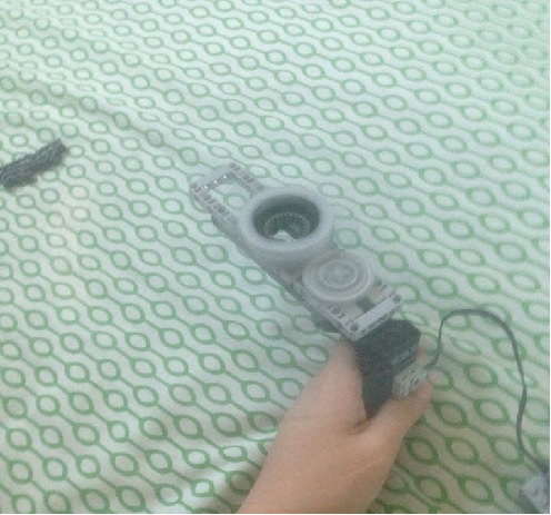

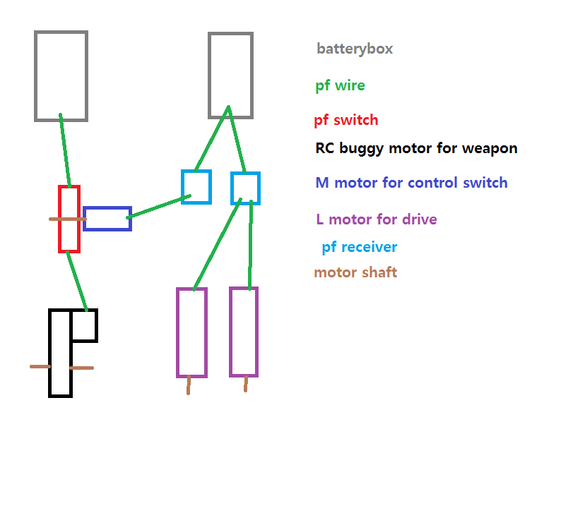

msk6003 Posted February 27, 2017 Posted February 27, 2017 (edited) my battlebot is replica of "icewave". Icewave is heavywaight class battlebot, use horizontal blade powered by 2-strok combustion engine. So it's very powerful and this is why I love icewave. Anyway, I will use 2 rechargible batterybox, 1 RC buggy motor for weapon, 1 M motor and 1 PF switch for weapon control, 2 L motor for move. Yes. this is how to work my "brickwave". Basically, icewave drive it's blade in the middle of body, so very smooth turntable need to blade rotation. LoL. I find turntable turn extremely smooth. Not modifited or sanding turntable. It's just rotation allmost 1.5 year. So it sanded itself. Hear's current build prograss. Gear is 40:56 from RC motor's fast output. I will upload more here when make. http://battlebots.wikia.com/wiki/Icewave info of icewave Edited April 3, 2017 by msk6003 Quote
PKW Posted February 27, 2017 Posted February 27, 2017 Icewave always impressed me, are you planning to but motor and weapon BB on the top of the build like the real one? it will be really awesome, also good luck with the blade it is really large, but you had a good idea powering the blade with a separate BB, RC motors has got a really high power consumption, the only way to make a bot with a single BB and one of them is hack the battery box thermal cut-off, but the buggy motor is so powerful that its consumption can melt cables if stalled, don't try! Looking forward for progress! Quote

JTS Posted February 28, 2017 Posted February 28, 2017 Would it not be easier to have two separate systems? I. E: System 1 = Battery>IR>Lmotors. System 2 = Battery>IR>Buggy. Quote
aminnich Posted February 28, 2017 Posted February 28, 2017 Ya, I do not understand you have the m motor connected to the switch which controls the buggy motor. Why not just connect the buggy motor to the receiver directly. Quote
msk6003 Posted February 28, 2017 Author Posted February 28, 2017 (edited) 30 minutes ago, aminnich said: Ya, I do not understand you have the m motor connected to the switch which controls the buggy motor. Why not just connect the buggy motor to the receiver directly. 34 minutes ago, JTS said: Would it not be easier to have two separate systems? I. E: System 1 = Battery>IR>Lmotors. System 2 = Battery>IR>Buggy. I think that way but soon cancled. Because buggy motor use so much power. reciver has currant remit and buggy motor easly cut off by reciver. If i use Sbrick, can use simple way but Sbrick's mobile phone control is damn to me and I dont have any game controller can use Sbrick. And have another probram. PF reciver can't fix rever on potion. It make hard to control robot. Edited February 28, 2017 by msk6003 Quote
PKW Posted February 28, 2017 Posted February 28, 2017 4 hours ago, msk6003 said: I think that way but soon cancled. Because buggy motor use so much power. reciver has currant remit and buggy motor easly cut off by reciver. If i use Sbrick, can use simple way but Sbrick's mobile phone control is damn to me and I dont have any game controller can use Sbrick. And have another probram. PF reciver can't fix rever on potion. It make hard to control robot. Despite BB and receivers protection being both 250mah (unless using v2 receivers that has a 750mah one) ir power consumption and circuits will result in a less power opupts so you're right I have both sbrick app (with custom profile) and game controller but it is too weird to drive with, I really prefer lego remotes and a sensible feedback Same thing as before but I can't understand the problem, remember that remote customization could be really useful on logo battle bots and also while controlling the switch make sure not to stall the motor and to prevent motor inertia from moving the switch to neutral when you release the remote lever (so an end stop and a fraction gear could be useful to control "power" "stop" and not clockwise, center clockwise and stop) Quote
