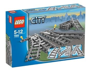

KikoTube Posted January 7, 2017 Posted January 7, 2017 (edited) IF THIS IS THE WRONG THEME PLS MOVE IT TO TOWN Hello AFOLs! I´m new to Lego Trains... I mean, i already had a few Train sets (7898,10194,7897) but I never built Train Moc´s or challenging Layouts. But i think this would be a cool Hobby. So i´ll build my own Layout, some Trains and a City. To build: 2 Trains with a few wagons. I thought about a cargotrain (like minecars) and a passengertransport. Buildings: Mine, Tenements, Rail Station and maybe some other Things if I get some more Ideas Layout: Actually i dont have a layout yet. But a idea. I have 68 of those: 37 of those: 1 of this: and 6 of those: I will Need some help at my layout. I dont have that much space but i would like to make a long track. I saw some Layouts, which had 2 Levels. I want do it aswell but which slope may it have? Thanks for Reading! Edited January 7, 2017 by KikoTube Quote
alican Posted January 7, 2017 Posted January 7, 2017 You can use BlueBricks software for designing track layouts and take a look at here for inclines. Quote
