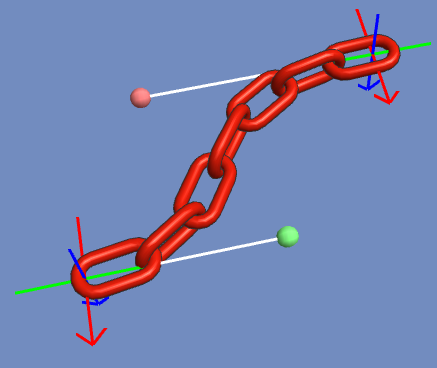

Splat Posted November 27, 2016 Author Posted November 27, 2016 On 11/24/2016 at 2:20 PM, Philo said: Hint: maybe it would be the opportunity to try LDCad that would make strings and chains MUCH easier to create... Expand Hi Philo. I tried to follow your advice, but I'm having a lot of trouble with LDCad (v1.5). I don't find the software very intuitive at all, but I'm sure that I just have to get used to it over time. I read through the documentation and thought that I would try to create a chain. As soon as I add a template part (chain) and then go to nested mode, the software bugs out and half of the interface disappears, including the menu, the toolbar, the compass, the pin, etc, making the software even harder to use. The same happens if I try to edit the chain submodel directly. I can't see the little yellow spheres that the documentation says are needed to be able to create the custom sized chain, so I can't resize my chain at all. For the time being I think that I'm giving up on LDCad. Quote
Philo Posted November 27, 2016 Posted November 27, 2016 Annoying... hopefully Roland will be able to understand what happens. My first idea would be a video driver issue, but... Quote
roland Posted November 27, 2016 Posted November 27, 2016 On 11/27/2016 at 7:58 AM, Splat said: As soon as I add a template part (chain) and then go to nested mode, the software bugs out and half of the interface disappears, including the menu, the toolbar, the compass, the pin, etc, making the software even harder to use. The same happens if I try to edit the chain submodel directly. I can't see the little yellow spheres that the documentation says are needed to be able to create the custom sized chain, so I can't resize my chain at all. For the time being I think that I'm giving up on LDCad. Expand I'm sorry for the problems you're having. I did some quick tests and the chain template works like it should on my windows (or are you using Linux?) setup so it indeed sounds like an video driver issue. Are you running a very low OpenGL version? Or using an overall older VGA card? It should look like the attached image. Quote
Splat Posted November 28, 2016 Author Posted November 28, 2016 Hi Roland. I am trying to use the Technic Chain template (part 3711). I'm running Windows 7 64 bit, OpenGL 2.1.0 (I don't have permissions to update this). I have also downloaded/unzipped v1.6 Alpha 4 and tried both 32 bit and 64 bit versions, but all I can see is the status bar and all of the rest of the screen is black. I can still mouse over items and see the description in the status bar, but I am basically running blind. Quote
roland Posted November 28, 2016 Posted November 28, 2016 On 11/28/2016 at 1:11 AM, Splat said: Hi Roland. I am trying to use the Technic Chain template (part 3711). I'm running Windows 7 64 bit, OpenGL 2.1.0 (I don't have permissions to update this). I have also downloaded/unzipped v1.6 Alpha 4 and tried both 32 bit and 64 bit versions, but all I can see is the status bar and all of the rest of the screen is black. I can still mouse over items and see the description in the status bar, but I am basically running blind. Expand I've added a new item to my FAQ section you could try: http://www.melkert.net/LDCad/faq#faq_fbo However a completely black render area points to an initialization failure, the black area should have a hint label stating this, the above workaround won't fix that. Quote
Splat Posted November 29, 2016 Author Posted November 29, 2016 On 11/28/2016 at 8:40 PM, roland said: I've added a new item to my FAQ section you could try: http://www.melkert.net/LDCad/faq#faq_fbo However a completely black render area points to an initialization failure, the black area should have a hint label stating this, the above workaround won't fix that. Expand Hi Roland. I am still running v1.6 Alpha 4. I updated the main.cfg file as suggested in your FAQ. When opening LDCad, I can now see the screen (no more black area), but as soon as I go to the Nested tab it freezes for a few seconds, and then the same thing happens as before where the interface items (menu/toolbar/compass/etc) disappear again. This happens in both 32 bit and 64 bit. I have already gone ahead and made my chains and string in MLCad. They don't line up 100%, but are close. I should be finished with the MLCad file in the next day or so. Quote
roland Posted November 29, 2016 Posted November 29, 2016 On 11/29/2016 at 12:18 AM, Splat said: I updated the main.cfg file as suggested in your FAQ. When opening LDCad, I can now see the screen (no more black area), but as soon as I go to the Nested tab it freezes for a few seconds, and then the same thing happens as before where the interface items (menu/toolbar/compass/etc) disappear again. This happens in both 32 bit and 64 bit. I have already gone ahead and made my chains and string in MLCad. They don't line up 100%, but are close. I should be finished with the MLCad file in the next day or so. Expand Too bad it didn't work, I think your VGA driver is just too outdated/buggy as OpenGL 2.1 is very old (most drivers are at 4.5). But as you can't update that I don't think I can help you any further. Quote
