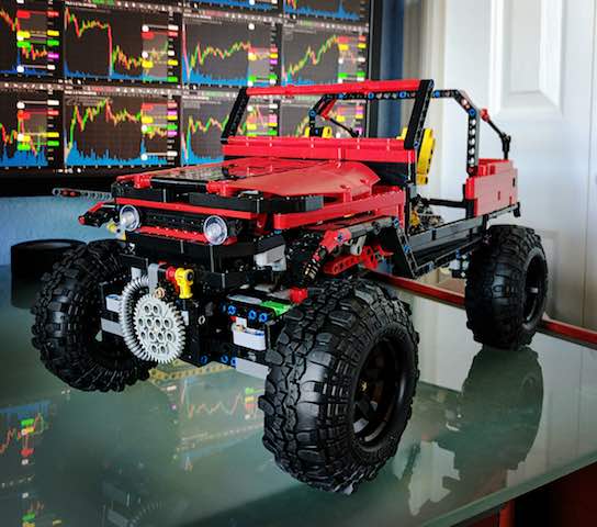

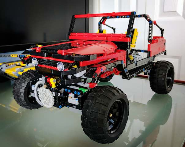

nerdsforprez Posted May 21, 2017 Posted May 21, 2017 Really loved this build - and TY for making the lxf file available. Being a fan of crawlers..... I gave building this one a go. Terrific machine. Details and thoughts of the machine and build are below: - Changed the color scheme. Orange, black and white. - Added PF lights. - Huge 2.2 RC tires. Much bigger than 1.9. Increased ground clearance by 3/4 of a minifig - Buwizz for power and control. - Small changes in building process I wasn't really surprised by the performance, which is terrific, because I thought it would be. The videos by the original builder are just fantastic. What I am surprised about however, is the durability. My version took its fair share of spills, falls, etc and really, relatively nothing broke or failed. Couple of the links get pulled out from time to time, but that is about it. I even have a crack in one of the U-joints in the front axle, but it is so well braced that I haven't even bothered changing it out. It really only skips in the most dire of situations. I hope to make a video soon. Videos can be hard for me as my kids spurn helping dad and his "geeky" projects. If I get my wife to help tape then well..... I have a whole weeks list of things to do to compensate..... We go on a trip here shortly but hope to get something done when we return. Couple of thoughts - - I am a OCD about friction. I think this arose from oven TLG warning of friction in their instructions and my building experience as a kid. Now, as an adult, I test my models through the whole building process for friction. If the infamous 42056 taught us anything it was the perils that can arise from too much friction. On step 109 I wondered if the thin 5L lift arm was needed. I get why it is there.... for bracing, but I hypothesized that it would not be needed. This was important b/c when testing the model at this point in the build the (w/o the motor) things were very difficult to turn. Tons of friction. Mostly due to the thin liftarm being flush with both beveled gears. So, I eliminated this lift arm - and .... no problems. No skipping of the gears, etc. This allows much more power to the front wheels. Which is needed because the 2.2 tires with rims are hefty and difficult to turn. - The steering is especially superb. Worm gear implemented is especially nice - Lego RC vehicles are fun to built, but honestly I have never really had much fun driving one. Perhaps that is because I have several real RC, brushless cars so the performance is not comparable. But, I truly have fun driving this crawler. Crawling is a different style of driving, much more about calculating and planning where to put your tires, power to add, etc. but this little guy is quite a bit of fun. - Buwizz can add alot of fun to not just vehicles built for speed, but also those that need power. Great for truck trials and speeded vehicles alike. Like I said, I will try to get a video soon. But hats-off to PTNYC for this build and for making the instructions. Had a lot of fun building this MOC and have even more driving it. Quote
nerdsforprez Posted June 5, 2017 Posted June 5, 2017 (edited) Finally got around to completing a video for this build. I hope it does the model justice in terms of demonstrating the amount of fun I had building and driving it. Seriously a great crawler..... the rock you see in the video that this crawler can scale is just under 12 inches tall. Here are some pictures at dusk with the lights: More information at: http://www.moc-pages.com/moc.php/439753 Higher resolution pics at: https://www.flickr.com/photos/nerdsforprez/albums/with/72157681874461761 Edited June 5, 2017 by nerdsforprez Quote
