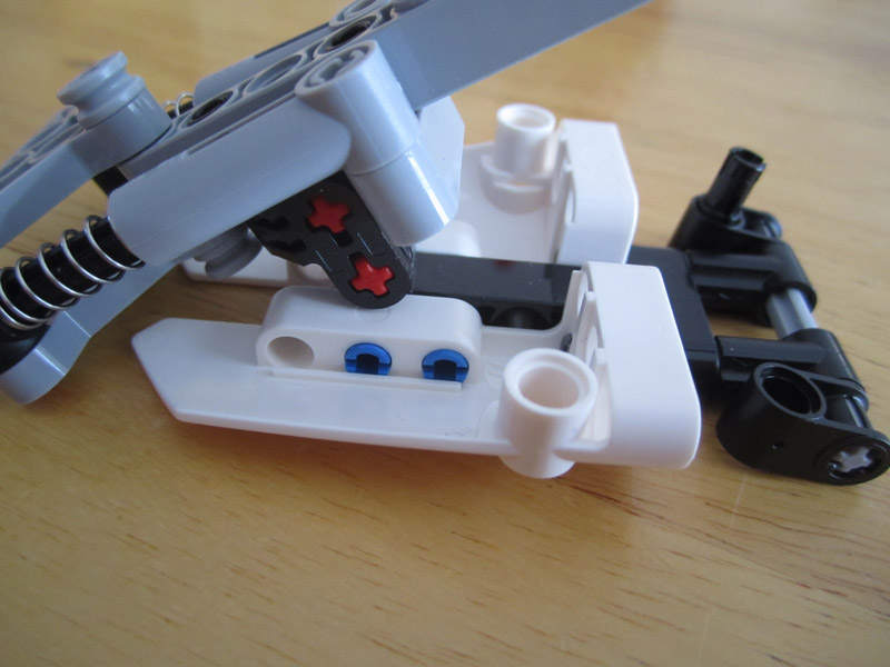

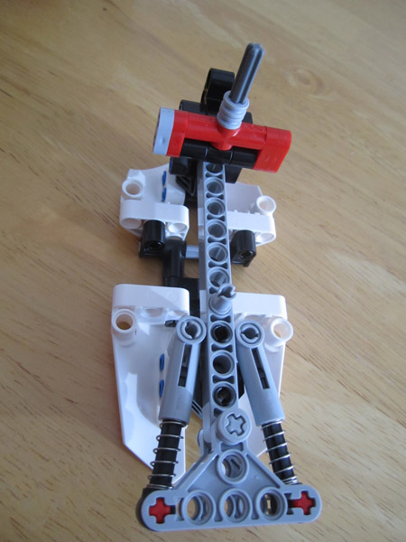

TBL Posted December 9, 2015 Posted December 9, 2015 Amazing, did you use a series of lift arms to make the cockpit open or did you use other methods? Quote

Hugolin Posted December 9, 2015 Author Posted December 9, 2015 (edited) did you use a series of lift arms to make the cockpit open or did you use other methods? I hope these photos meet your question: The mechanism for turning is so simple yet so effective. Was it a discovery by chance or did you have some intuition for it? Lucky yes, but especially a lot of thought and time. First, when I rediscovered LEGO, I did not have the reflex will see the creation on the Internet (I still did not know the existence of the forum). So I had no preconceived ideas when I thought about doing a hexapod. The first thing that came to my mind is the distance traveled by the right and left legs in a turn is not the same. The first hexapod was based solely on this principle to vary the amplitude of the legs. Here it is : For rotation better, the trajectory of the legs must be a curve and not a line. Second hexapod with the chassis that this curve in addition to the amplitude modulation: New version with motorized armament. We begin to see the shape appear on the last: The penultimate done to competition on the TechLug forum. The principle remains the same, but the mechanics changed a lot. A servomotor control the pivot points and the curvature of the frame. The mechanics of the latter is strongly inspired by that: In short, walking tank did not happen by chance. That deserves....instructions? I will try to make a manual, at least in picture. But I never made, so it will take a long time. Edited December 9, 2015 by Hugolin Quote

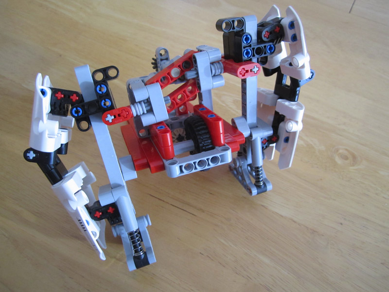

BusterHaus Posted December 9, 2015 Posted December 9, 2015 (edited) I copied the leg & amplitude mechanism a few months ago from the WIP pictures and videos. It's very clever, and features some nice building techniques. I made 3 sets of legs and got it it to walk, but my body bending mechanism had a lot of lag in it because of flex in the system. I took the project apart but kept a set of legs as a reminder. Here are some pictures: Edited December 9, 2015 by BusterHaus Quote
