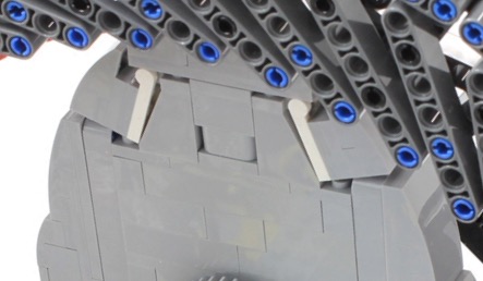

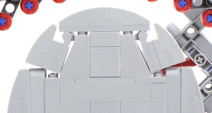

tismabrick Posted November 20, 2016 Posted November 20, 2016 (edited) I currently strugle with the inner light grey ellipse. Front and back of the smaller outer part is different. I think the front has two tiles attached (2x2, 1x2) where the back seems to have a technic piece. But I dunno how it's assembled. Any idea? Edited November 20, 2016 by tismabrick Quote
Courbet Posted November 20, 2016 Posted November 20, 2016 I believe this is made with the 2 tiles you mentioned, plus a 2x3 plate, 2 brackets (99781 and 99207), a regular 1x2 Brick and a 2L technic Beam. Quote
tismabrick Posted November 20, 2016 Posted November 20, 2016 Thanks, I'll give it a try. Why is he using a 2L technic Beam and not simply an ordinary 1x1x2 brick? Quote
