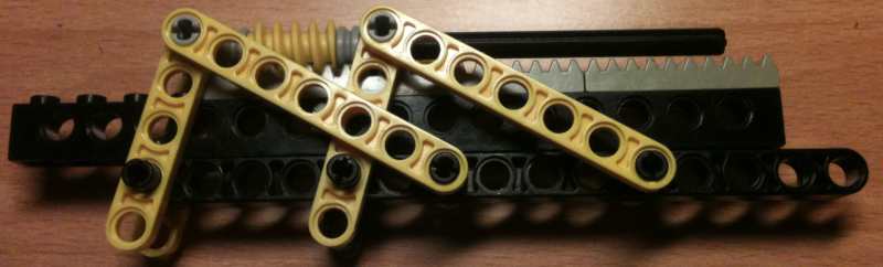

I have made a prototype of a smaller actuator. the main benefit is that it's only three studs wide. Is it done? nope Can it be improved Absolutly -

+1 :) They look very interesting -
I have tried using a worm gear and gear racks But i cant get it as stable as I want it. There was on verion on the net but that design was to tight (to much friction on the parts). The cheat way is to do something like the the threaded version that Jennifer clark used on her white crane I would need something capable of extending 12-16 studs.
