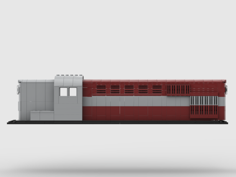

Thanks for the Replies so far, very much appreciate the feedback! I will definitely shoot you a line if I ever want to dig deeper in the model you made! Hi Ivan, I was able to find mechanical drawings for the RS-18 and those side grills are a tad oversized in my current model however I fear that the backside of a headlight might be too small. I have attached a picture of the drawings. Looking at the Alco RS-11 which is the Loco that the MLW RS-18 is based off of, it seems that the rear top bigger grill is a lot bigger on the Alco's compared to the RS-18's, which would make the 5 smaller ones seem off for an Alco. Not sure if any of those sentences made sense, too many adjectives of smaller and bigger ha! I will definitely keep this detail in the back of my mind however moving forward. Drawings: http://trainiax.net/drawings/18-mlw/rs/dim-18-mlw-rs18-cn-2b-m.GIF Thanks Zephyr. Currently for the cab I am using the airplane fuselage top. They are just there as a place holder for now to get an overall shape before I start making something out of individual bricks. In terms of the running boards are you suggesting extending them a plate downwards to make them thicker? For the length of the running boards I will for sure change, I had only slapped a few plates down to gauge the length for scaling. In terms of motor in this thing I do intend to use PF. Although I am very new to any type of motor use so not necessarily set on PF over PU, any suggestions for one of over the other? I have left the loco empty enough to slap those components in. I have made a flickr account to make posting multiple photos instead of the limited size of attachements. Here are some better photos with more angles. Yesterday and this morning I was more focused on making the trucks of the model hence no work on the body. For the trucks I am overall happy except for the horizontal cylinders being to far outwards. A few more details I need to add in are the brakes I believe (the linkages in front of each wheel is what I assume is brakes?). I also need to ensure that everything will be stiff enough, might have to build up a truck with my current collection to see if it will be sturdy enough. As I mentioned previously I am new to the ideal of playing with technic and power. For you veterans of making these locos does my drive train system make any lick of sense? Kind Regards,
