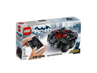

  2. Had this thing a while a now controls like an rc tank(No steering rack two sticks sliders for moving opposite the directions to turn) and you press a button to make it wheelie and your phone shouts Batman as well when it wheelies. I've got a new project in mind now for an rc mod and I wanna use a powered up hub but the one in this set is the only one I own right now. Is it useable with other rc creations? Tried using the app it connect with the batman controller app but just seems to ignore the others. For clarification what I'm building will have back wheel drive and steering so you'know the exact opposite of a tank like vehicle really. Just wanna know if it'll work before I spend hours cramming it all in only to find the box isn't compatible with anything else.
