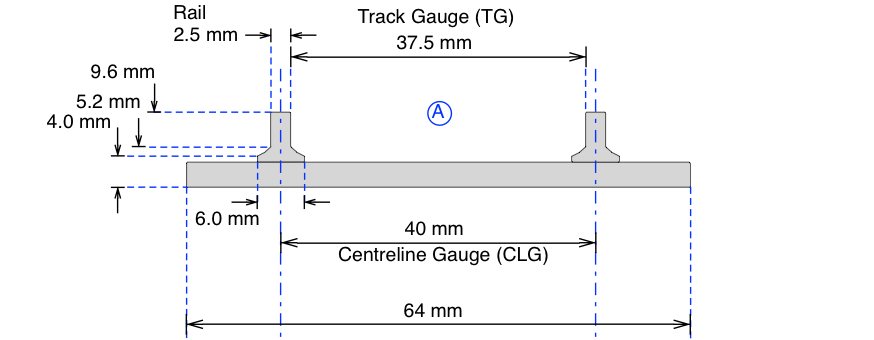

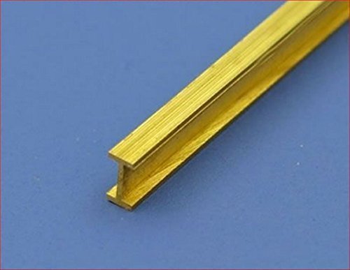

  1. @LegoTrainDude9231 - LEGO track has a very nearly rectangular profile instead of an I or T shape. Take a look at the diagrams from L-Gauge for reference Including this profiling in the rails would significantly thin the center of the rails and require an overhang. This is particularly relevant in the manufacturing processes- real-world steel or iron rails are produced as lengthwise rolled pieces, so they can readily produce these shapes. Plastic rails from LEGO are produced by injection molding, with the mold halves on the top and bottom of each rail. To separate from the mold there can't be overhang that would catch inside the mold and hold pieces in place. 3rd-party rails may be injection molded or 3D printed. Injection molding has the same problem with overhangs, and 3D-printing has resolution limits. Perhaps a cured-resin printer could produce the additional detail for the rail profile, but a typical extrusion printer would also need to contend with supporting an overhang if the rail profile had a wider head and narrower middle. If the rails were formed as extrusions this profile would make sense- if you wanted conductive tracks you could use plastic ties and railbed with metal rails:
