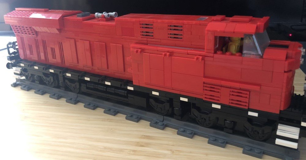

  8. @sed6 loved the design and modified it into a red/black scheme, much like Candian Pacific's coloring. I had wanted to go red with, had a lot of the bricks already. I will say, it was a bit of a tricky build but that also might of just been the way LDD put the instructions together; fun non the less. It really is a monster of a design. I'll try to get a photo next to my GP40s and or my steam engine.
