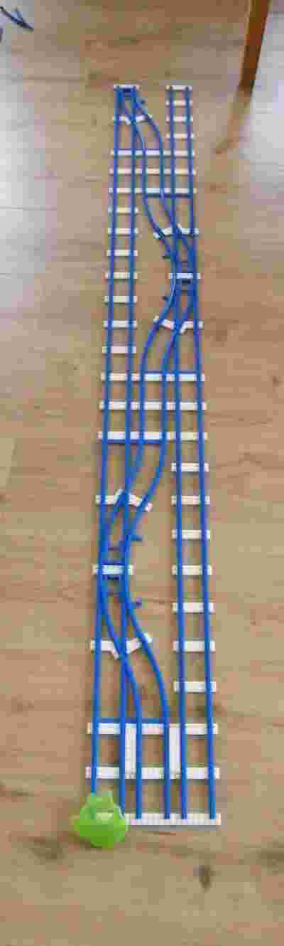

  11. Thanks guys. The solution seems to be keeping the curves out of the picture all right (although probably not for the 9V since the junctions are different). Here's what I have now. (Apologies for the image quality, I only seem to have 100K of uploads per thread :( I assume this changes after I'm here longer?) I tried to move the tracks closer together at the beginning and end but the issue with 2 curves not equal to the curve of the junction seems to be the problem again, but I solved this with another junction and then a deadend track (for storage etc.), marked by my son's teether (since he kept on grabbing the standing up sleepers I had there! :) ) Andy, I can see the advantage of the gab between the tracks for a station etc. but I kinda like the look of the tracks right beside eachother as well...

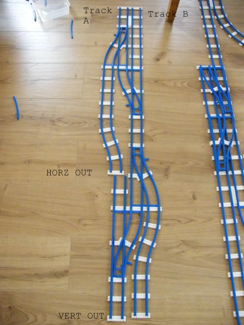

  12. Hi all, I'm trying to figure out how to do a crossover for 2 tracks in parallel and haven't had much success either trying myself or Googling. Maybe it's just not possible with the track geometry...? The crossover on the right of the attached image is ideally what I want, but of course there are no track pieces like this, so I have tried my own solution on the left with Track A and Track B. There is a horizontal and vertical displacement of 2 studs or so as you can see, this I assume is due to the fact that while the straight part of the junctions is the same as two regular straight tracks, the curves of the junctions are not equal to two curved peices of track. :( I want two ovals of track where trains can run on each independently but can cross from A to B and also from B to A without having to reverse etc. Is it possible? Can anybody direct me to a layout etc. were it has been done?
