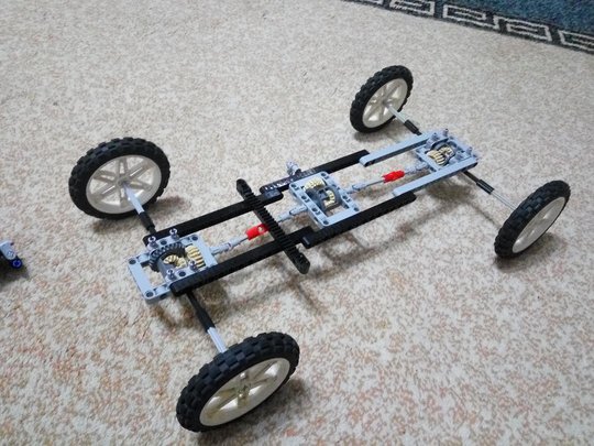

Ok, so i ran into truble when i started making the front stearing system. The thing is, i dont have the input shaft nor the suspension arms in order to make the articulated arms and drive axels to the wheels. So i had to find a way around it and i came up with this: https://ibb.co/ksKgEb https://ibb.co/gOhtub I had to make sure that the articulation for the drive is just over the universal joint and it works fine. We have FWD. Now I have to find a way to attache the suspenison. Question: Which is better: to have the articulation for the suspension closer to the body or closer to the wheel? And why? My guess is the closer the articulation to the center of the body => more off road capability. -
[MOC] 4x4 retro car help
Un_Dac replied to Un_Dac's topic in LEGO Technic, Mindstorms, Model Team and Scale Modeling
Thx, I'm sure I can get the independent suspension, stearing, and 4x4. I'm not sure how to make the the drive selector... Anyway, i'll build and maybe ask you guys as i go along. This is the progress so far after 30 min :) The two motors will be on the left and right side. The one that will power the drive train will be on the right and will be connected to the central differential from the sides. LE: this 100Kb limit for uploaded pictures... :( have to risize them...
