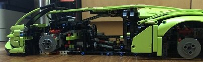

After two weeks of tinkering with your/jb70 8 speed+reverse with center differential gearbox, it will be more appropriate to set forward gear 2 as the default so that I can occasionally appreciate gear shift when I am the one "playing" with it :). But most of the time, I left the car on the floor at home so my kids will push it along mostly at default setup. Leaving it at gear 1 (working now) with kids abusing it will be a bit dangerous :). Btw, I have updates on Ackermann steering setup. Here is my latest Sian's belly shot. Let's focus on the front wheel. In stock build, there are 7M+15M to stitch the chassis-frontaxle-partofnose. The Ackermann steering setup that you guys added in causes rubbing with the 15M without the gear rack limiter, so jb70 added one at page 51 step 17. Let's quote Sian's promotional material again. "It seemed a shame to go to the trouble of simulating the intricate workings of the 8-speed sequential gearbox only to hide it away inside the model..." Here: "It seemed a shame to go to the trouble of simulating Ackermann steering to then limit its power again ..." So here is my version of this aspect. I took out the 15M black beam and reroute the "stitching part" to behind. So lengthen the black beam on the left of the original 15M beam, connect it with the front axle indicated with blue box, then use the space indicated in green box to connect it with the front section of the care (just before the nose). Hopefully it is clear enough? This setup is weaker than just using one long 15M beam of course but this solves the rubbing problem. Now when the car turns at maximum angle (picture below - left side, I push the wheel with force), the Ackermann setup will make the inside wheel turns more, but the removal of 15M beam will make the rubbing problem gone. PS: for picture below - right side, I show that the outer wheel doesn't rub with the 3M white (I ran out of 3M black beam) beam as it should be with Ackermann setup (and you can even shorten it to 2M beam if you want to). With this mod (i.e., not using gear rack limiter at page 51 step 17), you can now have Sian that turns tighter inside your room :D. I can say it turns tighter and better compared to stock build that doesn't have Ackermann setup and center differential (of course).
