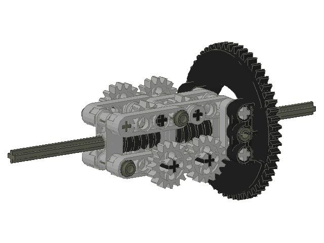

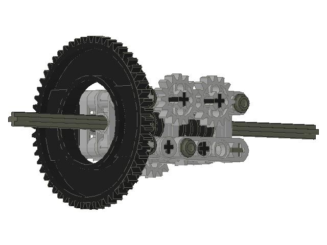

Zerobricks Posted July 18, 2010 Posted July 18, 2010 So, here is my first idea, a turntable differential. I built a simillar one for one of nicjasno's models. I used knob gears, which cannot slip and a 7 stud lego smooth axle. This give the diff a bit of friction when cornering, but its not really noticable with big models. I also built a model in LDD: http://www.brickshelf.com/gallery/zblj/Ideas/heavy_diff.lxf The next idea is a alternative solution to power up big models. Using four 8 tooth gears inside the tunrtable and a fith one to power it, i made a planetary gearbox with 1:3 ratio inside the power puller wheel. Also the turntable provides aditional rigidity. You can now use any normal differential to power up this wheel. The inner wheels: Top assembly is quite complex, yet sturdy: Because of the way two 8 tooth gears are attached inside, the assemby seems to work better one way, but its nothing too problematic: And the LDD file: http://www.brickshelf.com/gallery/zblj/Ideas/planet.lxf I will definatelly use this idea for any big truck. Quote
CP5670 Posted July 18, 2010 Posted July 18, 2010 (edited) Some great ideas here. This looks more robust than most of the limited-slip differentials I've seen before, which typically used rubber bands. Another solution to the issue of slipping wheels is a torsen differential like this one. If one wheel goes off the ground, this setup allows the idle wheel to transfer power to the grounded one. I like your planetary gearing setup too. Although I do wish TLG would give us a larger ring gear for doing this. The ring in the turntables is too small to do a lot with. Edited July 18, 2010 by CP5670 Quote
DLuders Posted July 18, 2010 Posted July 18, 2010 (edited) @ Zblj: I downloaded your LDD .lxf file and could see that the Turntable Differential is extremely strong. Mating a planetary gear setup to the turntable is a great idea. This TechnicBRICKS Blogspot post talked about planetary gears in the Power Miners-type wheels (parts 64711 + 64712 + 64713 ): Edited July 18, 2010 by dluders Quote
