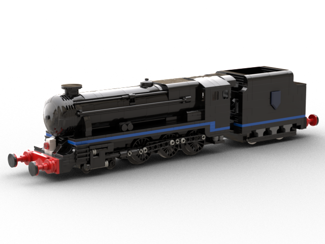

FGMatt Posted May 15, 2024 Posted May 15, 2024 Part of a bigger project upon which I'm working, but as I've finished the design I thought I might as well post it here! It's based on an LMS "Black Five" locomotive mostly because I needed a prototype to work from as I'm imagination-deficient, and I thought that looked about right! Motorised using both a train motor in the tender and a Technic motor driving the main wheels. I've put together some of the bits, but it's not quite finished in the brick yet so just a render for now. Quote
Murdoch17 Posted May 15, 2024 Posted May 15, 2024 Nice work! I do wonder if it will be able to go around curves, since the pistons hang so low as to block the travel of the pilot bogie. Keep up the good work! Quote
FGMatt Posted May 16, 2024 Author Posted May 16, 2024 18 hours ago, Murdoch17 said: Nice work! I do wonder if it will be able to go around curves, since the pistons hang so low as to block the travel of the pilot bogie. Keep up the good work! I think it should be OK as the pistons have a full stud width of space to allow the bogie to turn, however will test thoroughly! Quote
zephyr1934 Posted May 16, 2024 Posted May 16, 2024 Nice looking steamer! And yes, one should always test clearances on all types of track you plan to run on (switches and R__ curves) with a simple prototype that captures all the constraints before getting too far in a design. Quote
Ropefish Posted May 17, 2024 Posted May 17, 2024 especially the switch clearances! the rails reach up to the same height as a plate under any small wheel assembly. But! if you make a pilot truck upside down a tile will sit comfortably over. Quote
Feuer Zug Posted May 20, 2024 Posted May 20, 2024 Good looking locomotive. NPU with the new dome/sloped curve pieces to create the front of the boiler. Quote
CastleRail Posted May 20, 2024 Posted May 20, 2024 How are you planning on ensuring that the train motor and the technic motor drive at the same speed? Quote
FGMatt Posted May 21, 2024 Author Posted May 21, 2024 17 hours ago, CastleRail said: How are you planning on ensuring that the train motor and the technic motor drive at the same speed? The gearing on the Technic motor should be a little higher by my reckoning, meaning that the train motor has the mechanical advantage and should largely just force the Technic motor to run at the same speed... at least that's the theory! Will see how it works in practice. Quote
