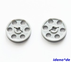

Mechbuilds Posted November 12, 2017 Posted November 12, 2017 I'm going to build a mech from technic. My problem is that mostly i've been building CCBS joints on these mechs which are sturdy enough to take some weight.. But now i'm thinking about making a bigger mech so the legs will need to hold more weight to them. I'm going with the chicken style legs which means that the knee joint is backwards. How can i make it sturdy enough? The bottom torso will have a big turntable and the legs will be attached by the smaller 3x3 turntables. How do i add friction to the turntables? Also what parts should i make the knee joints from? I'm thinking about ordering these: Can these joints hold weight if i put two of them per knee? The mech will be about 20-30 cm tall. Quote
Jeroen Ottens Posted November 12, 2017 Posted November 12, 2017 These parts have a very high friction. They click through different angles and it takes some force to do that. It most likely will hold the weight of your chicken, but if you want to motorize the legs you will need a very strong mechanism to do so. Quote
Mechbuilds Posted November 12, 2017 Author Posted November 12, 2017 Thanks for the heads up. I ordered 5 pieces. Here's a teaser of the mech so far: The 3x3 turntables have two gears each with one 1 long stud axle and one 2 long stud axle to add friction. These turntables take a medium amount of force to turn them. If the clicky joints have equal amount of friction, it'll be plenty enough. Quote
