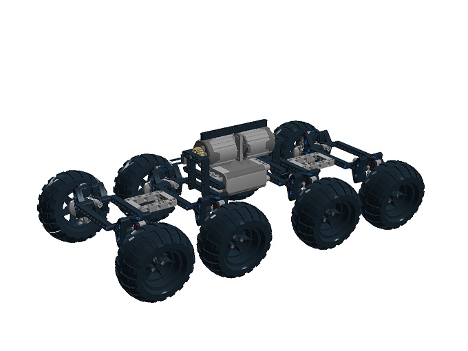

MarkusOSX Posted September 23, 2012 Posted September 23, 2012 (edited) Hi there, i´ve made my first 8x8 TrialTruck with LDD. 1787 parts. Saddly i don´t have the parts to build it. Maybe anyone of you want´s to try it in RL If interested, write me an i´ll send you the instruction. Greetz Markus Edited September 26, 2012 by MarkusOSX Added 'LDD' in title to clearify Quote
Superkalle Posted September 23, 2012 Posted September 23, 2012 Hi Great looking truck I'm moving this over to the Technic forum Quote

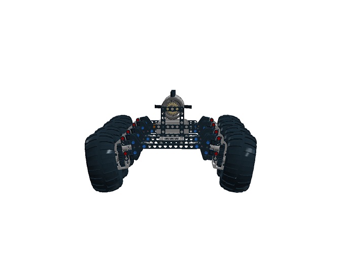

Zerobricks Posted September 23, 2012 Posted September 23, 2012 Looks good, but the suspnsion angle is waaaay too steep. Quote
MarkusOSX Posted September 23, 2012 Author Posted September 23, 2012 Hi Superkalle, thanks. Atm I'm trying to get all the parts at Ebay I needed. Greetz Markus Looks good, but the suspnsion angle is waaaay too steep. Do you think ? I've found many pic at IT with an angle simliar to mine. I'll try try it and change if its really too steep. But thanks for the info. Greets Markus Quote
skylinedan Posted September 23, 2012 Posted September 23, 2012 I can build that, I like your axle set up. I do agree though, the wheels have way to much positive camber. If you can just move the shock mounting points inward some and it should set the wheels better. I,d like to see the directions to this, very interesting. I ,d have to build it in yellow though, not orange. Dan Quote

MarkusOSX Posted September 23, 2012 Author Posted September 23, 2012 btw I've chosed this wheel angle to get the most traction out of the ballon wheels. Quote
Sariel Posted September 24, 2012 Posted September 24, 2012 (edited) It looks heavy, and 1 shock absorber per wheel may not be enough to support this weight properly. I think the sideways stability may not be good, too - the truck is tall, the heavy battery boxes are high in the chassis, and with portal axles at this angle you make it even taller, but not wider. One more reason not to build Trial Trucks with LDD only - LDD can't test it. Right now you put a lot of work into designing a truck that is completely untested. I hope it works well when built, but I think LDD is better suited for designing more static stuff, like castles. Edited September 24, 2012 by Sariel Quote
Bricktrain Posted September 24, 2012 Posted September 24, 2012 It looks good, I would be interested in building it, we have a lug 4x2 offroad challenge coming up it might be worth building it for. I think the suspension under load would settle enough to lower the camber angle anyway, it would still have plenty of droop travel, still it wouldnt be hard to fine tune the suspension, I have a selection of springs/shocks to test it with. Quote
efferman Posted September 24, 2012 Posted September 24, 2012 one shock absorber should be enough, because a soft suspension works much better than a hard one. but i think your center of gravity is to high in proportion to the actual trackwith. it will easily roll over the side. and are you sure that your steering system will work? Quote
MarkusOSX Posted September 24, 2012 Author Posted September 24, 2012 (edited) Hi all, One more reason not to build Trial Trucks with LDD only - LDD can't test it. I´ll use two virtual designers. With LDD I make the Model (design) and with SR3D-Bulder (with Animation Console) I´ll test the functions. I think it´s first possible to see if the suspension fits or not if the model is build in RL. But it wouldn´t be to difficult to change it. Your right with the center of gravity. Maybe one batterypack should be enough for these 3 motors, but atm i didn´t find another place for it deeper in the chasis. Meanwhile this was the fifth version i´ve build virtual. Another Concept with lockable differential and 2 gear speedbox Greetz and thanks for all comments. Markus Are you sure that your steering system will work? I guess, there was nothing complicated Edited September 24, 2012 by MarkusOSX Quote

MarkusOSX Posted September 24, 2012 Author Posted September 24, 2012 I think i´ll re-design the truck a little bit these days. Trying to get the center of gravity a little bit more to the bottom (maybe only using one batterypack) and changing the angle of the wheels. For those who i´ve send the LDD-File an instruction; please wait a little bit for "update" Greetz Markus Quote
DLuders Posted September 24, 2012 Posted September 24, 2012 It looks like it will take advantage of the rounded tire profile of the Lego Balloon Tires: Quote
MarkusOSX Posted September 25, 2012 Author Posted September 25, 2012 (edited) Hi there, what du you think of this gravity center setup ? ..and this angle of the wheels ? Wheel distance is now 2 studs more. Greetz Markus Edited September 25, 2012 by MarkusOSX Quote
efferman Posted September 25, 2012 Posted September 25, 2012 much better, now the tendence to roll over the side should be minimized Quote
MarkusOSX Posted September 25, 2012 Author Posted September 25, 2012 much better Ok, so I´m trying to build it new with this setup. Thanks Markus Quote
MarkusOSX Posted September 26, 2012 Author Posted September 26, 2012 (edited) Ok, i build it completely new. Not finished but good to see (thanks @efferman): Edited September 26, 2012 by MarkusOSX Quote
MarkusOSX Posted September 26, 2012 Author Posted September 26, 2012 (edited) Ok, endrun... The Chassis is ready. The cab should also fit in size and length, but need to positioned (not so easy in LDD)and some little corrections. Parts will be between 1800-1850 if finished. Hope you´re also satisfied with the new setup for gravity center and wheel angle. Greetz Markus Edited September 26, 2012 by MarkusOSX Quote

MarkusOSX Posted September 26, 2012 Author Posted September 26, 2012 (edited) Ok, time to compare: 1799 Parts Both trucks had the nearly same size cabin The trackwith is two studs more at the yellow one and the wheel angle is not so steep The whole truck is "flatter" The length is two stud shorter Think the best position for the Battery pack. Easy pull out from the underside. This version only uses one battery pack and only one IR receiver. I guess the truck is now more useful designed for trail, but i like the style also from the first version. Big thanks to efferman for his suggestion with the battery pack and also thanks to all other and their ideas. Last but not least: Which will be the best color for it ? Yellow? White? Black? Grey? Red? Orange? Green? Cool would be violet, but i don´t know if the panals are available in this color Does anyone know a good and free file sharer for the LDD file ? I would like to share it to everyone. Would be nice to see in RL. Greetz Markus Edited September 27, 2012 by MarkusOSX Quote
