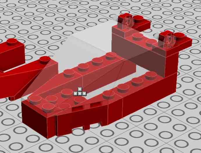

Last days I'm meeting with slightly misplaced bricks like the 93606 Brick with bow 2x4 or 61678 Brick with bow 1x4. When I connect it with another brick, it do this:
(How it look after putting it, note the 93606 is slightly back so there is a edge and cannot be connected another brick behind it/or you can't connect it ahead of brick (ex. flat tile or any bigger brick unless is corrected))
How it should looks like:
(After "correcting" note there is no edge, it's smooth)
(Also, please click to the picture for original size, it's better to see it)
Does anyone have the same problem?

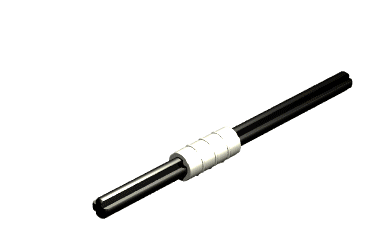

Here's another one having to do with the driving ring for a clutch gear.
The red driving ring (#6539) has a channel in the middle of it for a lever to move the ring back and forth. The yellow thin lift arm (#6632) fits in this slot very nicely - in real life only!
At first I thought there was a geometry problem with the driving ring but visually I just can't seem to maneuver the lift arm directly over the slot. It's always just a bit off.
It looks to me like the resolution of the positioning grid doesn't permit the two parts to meet properly. Is this a bug or is there a trick I don't know about?
That's probably so. There was a post about this (how to "cheat" the grid), but I can't really remember when. Maybe someone else remembers (or can explain how to do it)
Sometimes all that's needed is the germ of an idea - and you gave it to me. Visually, it looks like the part should be halfway between two adjacent grid positions.

@ iceleftd: Very clever! :classic: It should be noted, however, that the normal part for the Technic Driving Ring is the 6641 "Technic Changeover Catch" (which has a Technic Axle hole on the flat, square portion facing away from the camera). That part exists in LDDextended mode:
I thought about it for a second and figured out that I could hack the file. The result is this:
The steps I took were:
  1. Export the file with the liftarm in both positions (on both sides of the driving ring groove).
  2. Edit both files and find the entries for the liftarm.
  3. Calculate the averages of the tx, ty and tz values.
  4. Replace the tx, ty and tz values in one of the files with the averaged values.
  5. Save this file and re-import.
  6. The liftarm is now centered on the driving ring's groove and can be rotated into place as shown.
This positioning can be saved just fine and the two objects can be moved as long as they are moved together. If the liftarm is moved separately, it snaps back to the grid and you have to go back to step 1.
Obviously this is still a bug that should be fixed someday, I'm just not sure of the best way.
Yepp, that was one of the methods (hard core editing :tongue:)
But I seem to remember there was a clever way to do it in the GUI too.
Angled freemovers. For example, move .5 LDU in +X Plane and 1.5 LDU in +Y Plane (since 2 LDU is smallest move) then do .5 X and 1.5 -Y for a sum total of 1 X, 0 Y. Two angled freemovers set to 22.5 degrees and positioned properly would achieve this. The math is rather simple to figure from there.
I used 3.0625 degrees on the front panels of the Galactic Enforcer to move them down .125 LDU (0.05mm) to avoid a collision.
Thanks for pointing this part out. The use of a thin liftarm as a substitute permits the shifting axle to be parallel to the driving ring axle and only 2 LU apart. I can't think of a way to do that using 6641 and the same axle orientation without moving the axles 5 LU apart.
@ iceleftd: From Blakbird's Technicopedia, here's how the Lego Technic Driving Ring works: "The driving ring, in combination with a pair of idler gears which do not turn with their axle of support, allow functions to be engaged or disengaged. It slides over the ridged axle joiner which we first saw in 1993. Small tabs on the driving ring allow it to lock along these ridges, but still slide with some extra force. The driving ring grips the longitudinal grooves on the axle joiner causing them to rotate together. A circumferential groove in the middle of the ring allows it to be pushed along the axle joiner in either direction. A set of 4 driving dogs on either end then mate with a 16 tooth idler gear allowing the idler's rotation to be either synched with the axle or allowed to spin freely.
"The animation shows how the new driving rings work to engage and disengage the clutch/idler gears. The driving ring is shown in red. The lower axles are joined with the gray axle joiner. The driving ring rotates with the axles. At first, the driving ring is disengaged so both the dark gray and green gears are not driven and slip on the axle. The driving ring then engages the green gear and thus drives the blue gear. Because the driving ring does not use gear teeth but rather uses four tapered driving dogs, there is considerable backlash between the driving ring and the gear. The allows the driving ring to be engaged even while it and the mating idler gear are turning at different speeds.
"A fairly small number of sets have contained these parts over the years. It is generally used either in a transmission used for gear changes or in a gearbox used to select between multiple motorized functions. The driving ring originally always light gray but has more recently been typically red."
