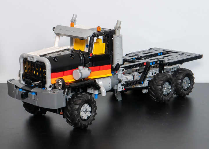

gyenesvi Posted November 18, 2024 Posted November 18, 2024 4 hours ago, nico71 said: This model was designed about 1 year ago, so now I think I could make even better with heavy CV join and split connector as I do on my upcoming 6x6 truck (yes the floating Toggle Joint is inspired from your Ford :) ) Nice looking truck! Interesting solution for connecting the spring to the lower towball arms! This small scale has a so much potential :) Yes I know about that heavy duty CV joint technique, I haven't used it yet but plan to test it in the future. Glad you got some inspiration from mine as well! Quote

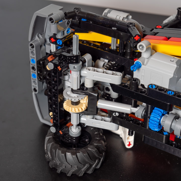

nico71 Posted November 19, 2024 Author Posted November 19, 2024 (edited) Thanks Gyenesvi, I embed the picture here for everyone : So this is a WIP truck, 6x6. The picture of the front axle underneath : Which is a combination of several small trick to obtain a strong and steerable / drivable axle at this scale with using heavy CV join. I have make some research to find the original author / inspiration to credit them : Floating U shape connector (remove one U join, very useful with the long reinforced CV join) I inspire by you but in fact this is way older : https://rebrickable.com/mocs/MOC-119108/Bricklab2006/mini-4x4-rc-offroader-buwizz-30/#details (from 2022) Use of split connector + heavy cv join : I discovered here but in fact it exist for longer time here : https://rebrickable.com/mocs/MOC-149669/Apachaihapachai/terracotta-pickup-truck/#details (from 2023) The double gearing on the center is very old technique, I can remember when it popped. For the rest of the technique, I do not know if I am the original author but I just use like that when building. As you mentioned, the spring is attached to the arms, as this is a live axle (5 links), the spring as only to work up and down like a trailing arm and so not complicated build to enable crossing axle. The arm with towball is attached underneath the axle, so on heavy load, we can think it can be taken apart but in fact there is a bar with balls above which secure the towball pins, and where a links 6l is connected (not present on the picture). so it gives the 4 links. The last one is a panhard rod on the front. Then, the front part of the axle is composed of layer of half beam and 7L beam the closer it is possible to the drive axle, in order to avoid the wheel to camber ot much. As there is no attachment point underneath. Not perfect, but better than everything I have seen before at this scale. I need to connect the servo motor for the steering. But I would like to avoid join so direct actuation with link, but I want also a removable working engine so I have to make compromizz on space. Then a two-speed gearbox, a proper design and it will be ready for testing :) Indeed, this is my preferred scale (1/20 and 1/17) for trucks. Edited November 19, 2024 by nico71 Quote
jorgeopesi Posted November 19, 2024 Posted November 19, 2024 Very nice front axle and truck. I already saw the same configuration in a Nissan Patrol by electro, I always think how to build small drive and steer axles but I did not achieve this solution. Quote
nico71 Posted November 19, 2024 Author Posted November 19, 2024 3 hours ago, jorgeopesi said: Very nice front axle and truck. I already saw the same configuration in a Nissan Patrol by electro, I always think how to build small drive and steer axles but I did not achieve this solution. This Patrol is very recent, mostly inspired by other, surely by Apachaihapachai. Indeed, that is not easy to create a small driven and steerable axle, but the part combination is only one side for the solution. The other side is to containing the weight and the axle geometry to keep low the taken-apart force. Quote
jorgeopesi Posted November 19, 2024 Posted November 19, 2024 6 hours ago, nico71 said: This Patrol is very recent, mostly inspired by other, surely by Apachaihapachai. Indeed, that is not easy to create a small driven and steerable axle, but the part combination is only one side for the solution. The other side is to containing the weight and the axle geometry to keep low the taken-apart force. The part I like most from this design is the extra stud for the wheel, I can not use designs with only one stud for wheels. Quote

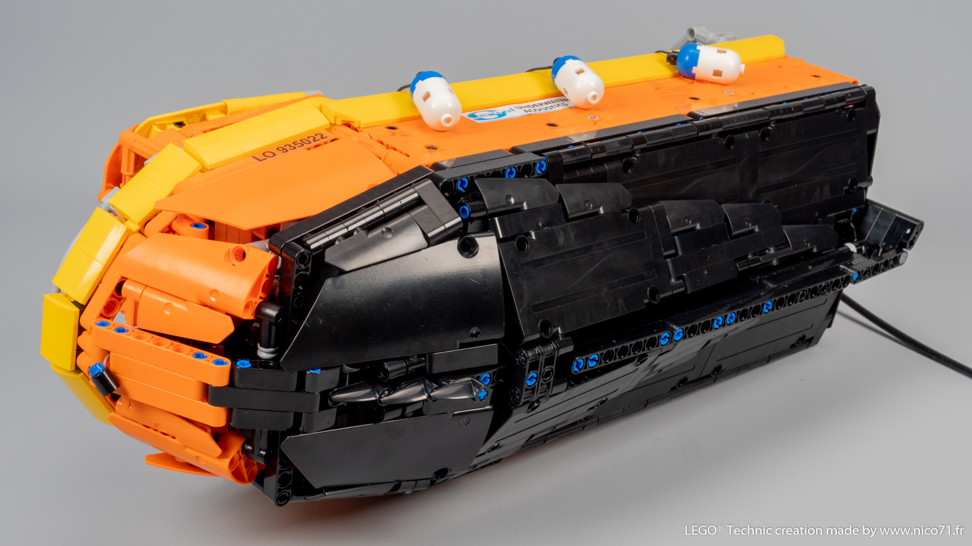

nico71 Posted April 17, 2025 Author Posted April 17, 2025 A new creation quite unusual, a 30ft workboat, based on Jemar Norpower 30ft boat, with dual winch with ratchet and probe, front winch, seismic element supports, and opening engine cover. Specs and History : Dimensions : 46x19x25cm (without end probe), scale 1/23, 1789 pcs Dual winchs with 2/4mm hose with ratchet mechanisms on each Front winch with ratchet (no anchor) Two seismic probes Retractable side sensor (sliding mechanism with two sections) Articulated rear gantry for support the probe hoses Articulated side arms for probe hoses recovery Openable rear guardrail Openable engine cover Articulated rudder (non functional) Detailed offset cabin with interior Support Frame Original Model : This boat is used for seismic exploration using acoustic probe in the sea. The 1 km cable is unloaded with the winch and pull in the sea, where the end probe can move to adjust its direction and depth and communicates with the boat directly though the cable. After the data acquisition, the boat use the telescopic cable lifter and the two flaps to lift the cable from the sea to wind back and get the probe. The cable lifter can also be equipped with fixed acoustic sensor (displayed on the LEGO model). You can see the real boat in action here In action : About the model : This model was designed in 2022, based on Jenmar Norpower boat with Sercel Livery. The aim was to display in a showroom to show the functioning of the boat. That is why it doesn’t float and is not motorized. It was nevertheless quite a challenge to reproduce the boat, especially the hull and the colored decks with all the details, as well as the seismic specific functions to be functional without affecting the sturdiness of the model. After some demands and good feedback on the overall design, I decided to make the PDF instructions as it can be easily modified to accommodate other purpose such as fishing, rescue, research etc. The instructions is available on my website and rebrickable. Quote

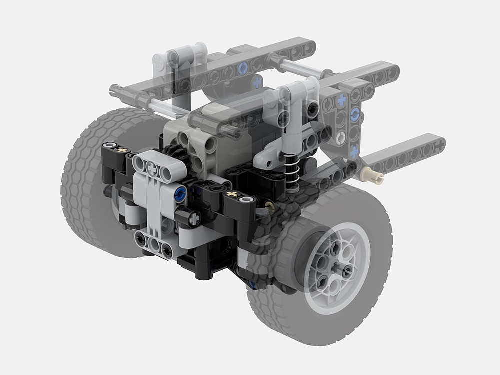

nico71 Posted October 3, 2025 Author Posted October 3, 2025 A small post to let you know I issued 3x free instructions for 11l motorized front axle using the news 3l suspensions arms from the Bronco. Background : The release of the new 3L suspensions arm is a very good news for axle building. The previous 5l arms was too big to create short width axle with gearead hub. So it was mainly use for 1/17 truck with 62.4mm wheel. After buying a LEGO Bronco, I start making 11-stud width axle which opens a wide range of LEGO Truck. Indeed, for trucks which have large tires compared to their width (for instance 13R22.5 14R24 or 16R20 like heavy hauler, logging truck, offraod truck, or military one), it is mandatory to reduce the width of the axle by 2 studs to comply with the scale if using the 62.4mm wheel. So here are the result, a 11-stud wide motorized front axle for truck with big tires at 1/19-1/21 scale, with free instructions and 3D models. Available in 3 Versions : No Onboard Servo : Onboard PF servo : Onboard PU (control+) Version : Specs : – 11-stud width (knuckle to knuckle), 13cm wide with 62.4mm wheel – Geared hub + CV-join (only two needed, other are standard CV-Join) – Inclined underneath suspensions arms (can be considered as illegal but give better ground clearance and differential secured) – Equipped with a 28t simple bevel differential, No onboard version compatible with all the differential. Onboard version NOT compatible with red 28t of yellow 22t crown – Steering with rack and pinion, 4 studs distance from the knuckle axis to use 180° of rotation of the Servo motor without forcing on axle end stops – Suspended with 3 or 4 links (2+1 central or 2+2 lateral) + 2 springs with lateral movement constricted (can be replaced by harder if needed), no need of Panhard rod but you can add one for better stability – Simple chassis for suspension mounting included (can be used for car depending of the scale, like pickup truck) Downloads : PDF instructions and 3D model (Ldraw+Studio) for building convenience https://rebrickable.com/mocs/MOC-236196/Nico71/11-stud-motorized-front-axle-no-onboard-servo/#details https://rebrickable.com/mocs/MOC-234780/Nico71/11-stud-motorized-front-axle-onboard-pfs-servo/#details https://rebrickable.com/mocs/MOC-236302/Nico71/11-stud-motorized-front-axle-onboard-pu-servo/#details Have a nice build with these, please credit me if you reuse the model in case of commercial use 👍 Also, for tracking, here is the dedicated topic to my 6x6 Offroad Truck released in May if you missed it : Quote
gyenesvi Posted October 3, 2025 Posted October 3, 2025 Nice axles, I knew someone would start using these parts for good :) And great that you cover multiple steering options. Quote
1gor Posted October 3, 2025 Posted October 3, 2025 Nico, I made similar axle for my upcoming project with CLAAS tires and it worked with daytona differentials, they are just fit inside curvature of PF servo motor, but lower suspension part should not be angled, but straight (I use Unimog uirque tube and 2 black 5 x 7 liftarms)... But your idea us also great Quote
Jundis Posted October 3, 2025 Posted October 3, 2025 Oh man completely overlooked the beautiful boat! And the simplicity and compact form of the axle is really cool, too :D Quote
nico71 Posted October 7, 2025 Author Posted October 7, 2025 On 10/3/2025 at 9:05 PM, 1gor said: Nico, I made similar axle for my upcoming project with CLAAS tires and it worked with daytona differentials, they are just fit inside curvature of PF servo motor, but lower suspension part should not be angled, but straight (I use Unimog uirque tube and 2 black 5 x 7 liftarms)... But your idea us also great Thanks ! If I fit the Daytona diff, it collides with the servo, so I think you raise by one stud the servo on your model, which is not possible here because on the top it should be room for the fake engine, so I have made to compromize. If you have link on your work, let me know. For the suspension arms, there are angled to have more ground clearance and better secure the cv join and axle inside the diff. It is not illegal to my understanding as it doesn't force on the part but use the natural play, but clearly "out" the grid system. On 10/3/2025 at 9:59 PM, Jundis said: Oh man completely overlooked the beautiful boat! And the simplicity and compact form of the axle is really cool, too :D Thanks ! Quote
1gor Posted October 7, 2025 Posted October 7, 2025 3 hours ago, nico71 said: Thanks ! If I fit the Daytona diff, it collides with the servo, so I think you raise by one stud the servo on your model, which is not possible here because on the top it should be room for the fake engine, so I have made to compromize. If you have link on your work, let me know. For the suspension arms, there are angled to have more ground clearance and better secure the cv join and axle inside the diff. It is not illegal to my understanding as it doesn't force on the part but use the natural play, but clearly "out" the grid system. I also look for as compact as possible solution...I'll see when I'll have hour or two time to post it in my topic and we can compare them...If your is one studs lower than I have solution for my problem...because of slack in CV or universal joints on 4 steering model aftont and rear axle are not allign after some time... Quote
